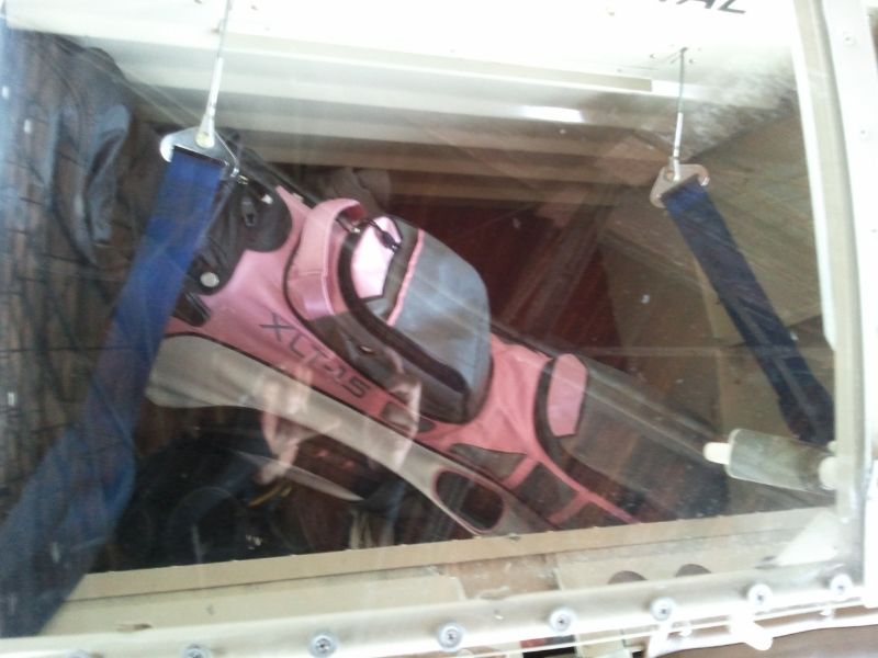

I'm currently shopping for a 6 and I've read it's possible to carry 2 sets of golf clubs in the baggage compartment, but I've yet to see a picture. Could somebody post a picture next time they perform this magic trick? Many thanks!

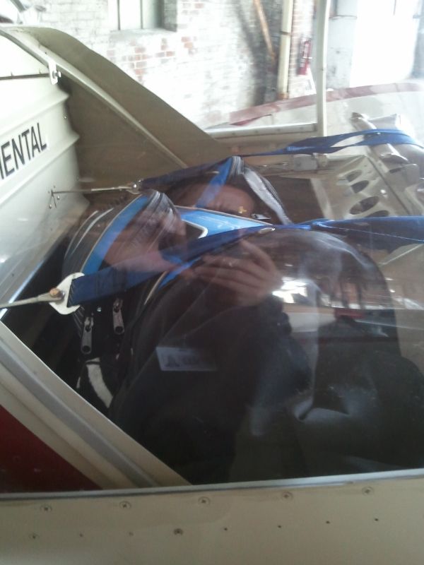

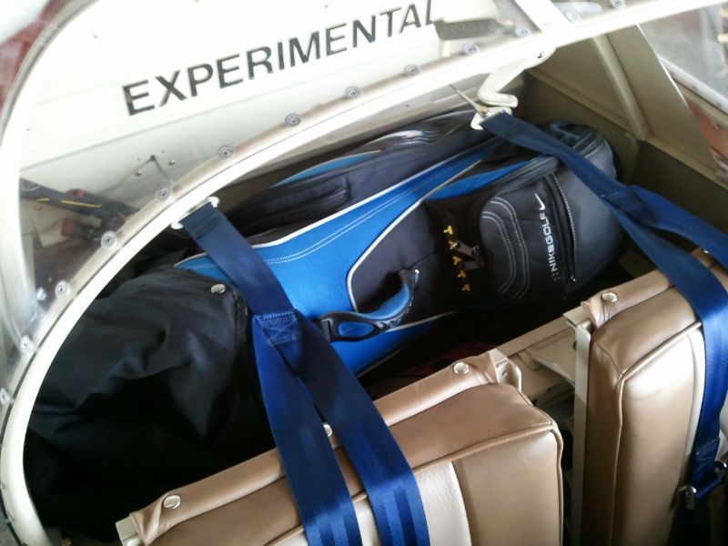

Yes it can be done. Here are some pictures. You will have to take the drivers and long hybrids out, but most irons should fit staying in the bag. (Standard size clubs) The drivers and hybrids will have to be placed diagonal in order to fit and get the canopy to close. Very easy to do. Watch the weight on the bags though. (Although this is a very good excuse to clean out your bag.)
More about a recent RV golf trip here:
1st bag goes in diagonal:
Place hybrids/long irons on top, then put in 2nd bag.
If you don't have a Bison Mountain Bag, I highly recommend one, it allows you to use the whole baggage compartment for bags, while keeping all your flight gear and tool bag neatly tucked behind a seat.
