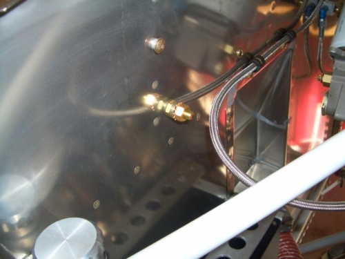

I put mine on the interior of the firewall, up high and near the center (over the battery).
You can see what is on the other side (engine side of firewall). Plenty of room for the cowling hinge pins. Engine ground strap comes to the stud on the far right. Battery ground goes to the larger stud on the forest of tabs ground block.
