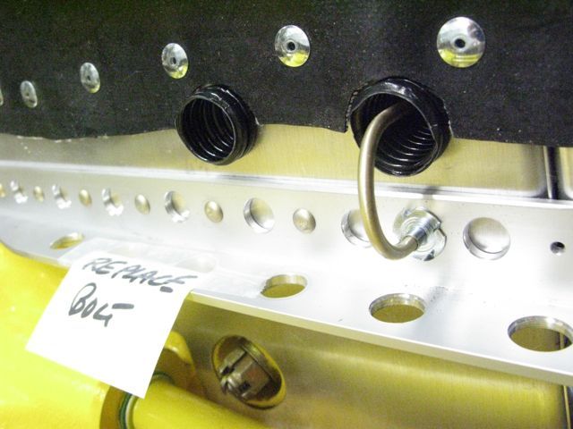

For those of you who have P-Mags in your plane, how did you route the blast tubes for cooling? I have an RV-9A with an O-320. Mostly I'm interested in how you fixed the position of the tube right at the P-Mag. there's not much around there to hook it to. Pictures would be great. Thanks!

I just put a hole in the rear of the baffle, one each side directly above each P-Mag for the blast tubes. And then zip tied the tubes to the engine mount, directing the blast onto the base of the P-Mags. I was a little concerned that the movement of the engine might dislodge the tubes from the baffle. but the tubes must have enough flex, as in 200 hrs they are still good and doing their job.

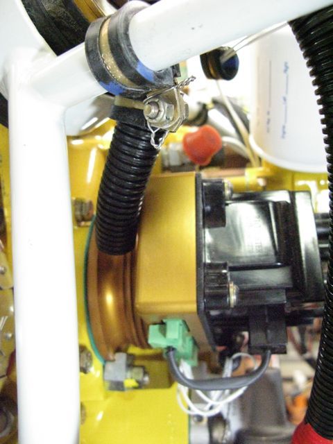

I routed the blast tube (I used 5/8" SCAT ducting) under the engine mount tube, i.e. between the engine mount tube and the accessory case. And it makes contact with neither the engine accessory case nor the engine mount tube. It has about 1/4" clearance to each. See first two photos.
Then, to position the blast tube at the P-Mag end, I made a little fixture that attaches to the engine via the upper magneto clamp stud. This way, both ends of the blast tube are attached to the engine, never to the engine mount, so there is no relative motion to worry about.
The attachment fixture has a handful of parts, but it's quite simple. A little tab of 0.032" sheet aluminum attaches to the upper magneto clamp stud on the engine. Then a short length of 5/8" aluminum tubing is attached to the tab via an aluminum tubing clamp. And finally the SCAT duct is attached to the aluminum tube using a hose clamp. Makes for an installation that's neat, robust, and easily adjustable. See the third photo.

Here's how I did mine... The rod is 1/8 brazing rod with the flux knocked off. One end threaded, 6-32 if I remember right, and bent to hold the shape you want the blast tube to take. Not flying yet so longevity unknown.

Not tested yet but this is what I did. In the last photo, the mag has been removed to install the SD-20 but the end of the tube is visable as it is wired into place. Just one idea!
