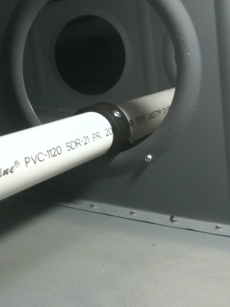

I tried those on my -7 wings, but I didn't want to drill through the stiffening rings, so I added some tabs.
Five brackets hold a piece of DWV quite firmly:
I thought I was home free until time to install the W-818 aileron push rod. No go.
I couldn't see anywhwere to mount these without the conduit interfering with either the push rod or riveting the bottom skin. YMMV with RV-9 wings. Took them out and will just run a string through snap bushings for any wiring that overflows the black corrugated conduit I installed per plans.
