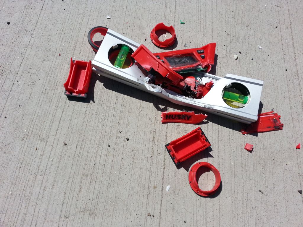

Setting up the wings for drilling the rear spar, after setting fuse level, wing sweep, and wings level
with the spacer, I am finding that from the top skin to the top of rear fuse spare I measure .125" difference from L to R. I know the wings are the same incidence, I measured 432 times. Is this normal?

Never mind, I found the problem.....Note to self. Do not use cheap a$$ tools for critical measurements.

Like Bob, mine was off a bit as well. Not by as much, but it was more than 1/8" for sure.
I have that same kind of level. It's as repeatable as a blue spirit level BUT it has to be oriented the same way to get the same repeatability. That means the display would be towards the wingtip on one side, and towards the fuselage on the other for example. That said, the spirit level is what I used on my wings.

Yep, it's not so much the tool, but how you use it. A cheap level might have very poor absolute accuracy, but would still be very precise from one use to the next at a given orientation. Even with a more expensive level, you wouldn't want to rely on its absolute accuracy. You'd want to use it in ways that are governed by precision instead, a good example being what ChiefPilot suggested.

Looks like that level is Tango Uniform. Husky tools are guaranteed for life. Take the pieces to Home Depot and tell them you are a railroad engineer and it got hit while measuring tracks!
Seriously though, it's great you found the problem.

I hope everybody knows to always flip a level end for end and average the bubble position.
This eliminates the inherent error of construction of the level. It allows a bad level to be used in an accurate manner. It is good practice even with well made levels.

A no go, I was in the sun for 4 hours setting everything up, brought everything in for lunch, came back out and the R wing incidence was . 4 deg different! Just for S... And Giggles I put my calibrated Samsung galaxy S 3 on there and sure enough they were off by .4 deg I don't know if the sun and heat made the tool read different or what, but that tool is history!
