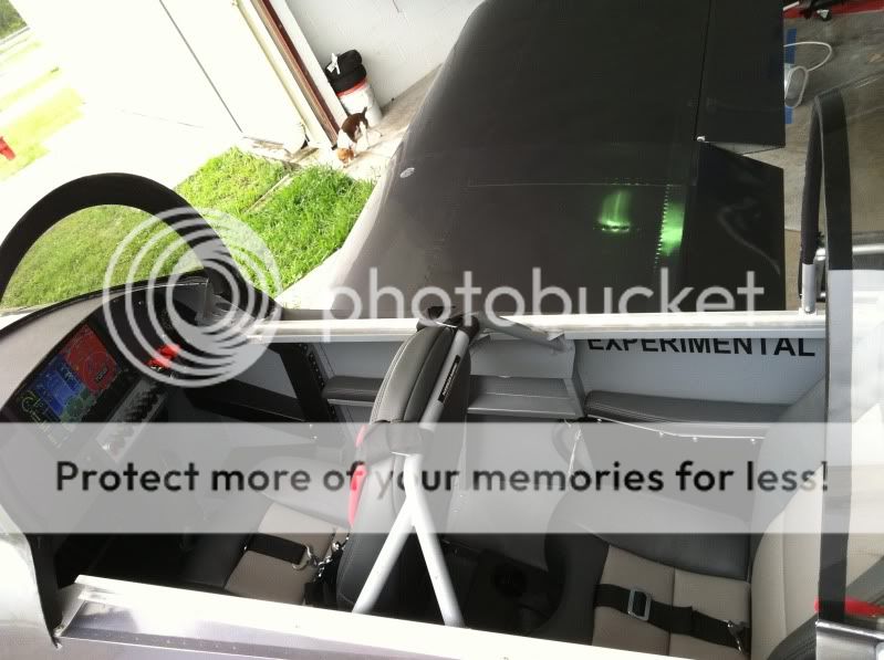

Figured I'd add my RV8 weight to this thread:
1030lbs full flight weight with everything. Aviation scales used.
I've got a spreadsheet of 100's of RV weights. I think the closest 8 to my weight was a rather bare interior and unpainted version.
Weight was always a focus of my build. This is what prompted the development of aircraftwraps.
Low weight Factors: vinyl both interior and exterior, Groove gear, LiPro battery, skyview system, single MGL V6, Catto prop.
High weight factor: Classic Aero Seats (3-4hr flight comfort ), fuel and me. The rest stays behind.
Love these seats!
