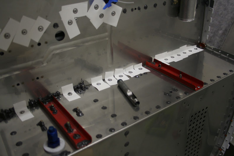

First time post. I have a question about what type of sealant to use , fuel tank sealant or firewall sealant and is it required to cover all pulled rivets? Also, if covered, is their any thought about viberation causing rivets to loosen that might be masked by sealant, or just overthinking. Anxious to start on engine. Thanks for all input!

I used 3M Fire Barrier 2000+ on the firewall and to seal the pulled rivets. You need a fire retardant sealant here, not Pro-Seal. There is no reason to think that vibration would loosen a properly set rivet.

This is not correct if you are building E-LSA.
The KAI stipulates that you are to seal each rivet (along with the panel seams and other gaps).
A major reason is, regardless what you think, the blind rivets are not sealed.
Oil, etc., can and will pass through them.
High temp RTV is not a good choice of sealant because it is not fuel resistant.

I am building to E-LSA, and will cover all rivet heads. Plans show both fuel tank and firewall sealant which to use? Would appreciate any photos of firewalls as i am trying to make this as neet as possible. Thanks again!

Some fuel tank sealant is used in the joint between the vertical and horizontal sections of the firewall, as called out in the plans. Fire sealant is used generally where the fuselage skins met the firewall, and to seal the rivets and any other gaps. The plans tell you where to use it. This picture is from Tony Tessitore's build site. I'm sure he won't mind me posting a link here. If you want to see masterful workmanship, have a look through his collection of photos.
http://tonytessitore.smugmug.com/RV-...8dhkj&lb=1&s=A
I used masking tape to make neat little squares around each of the rivets before applying the sealant, but it still looks pretty ugly.

Sorry Rod. Sometimes when you ask a simple question you don't always get a simple answer here on the form. The answer is use Pro Seal, otherwise known as FlameMaster. The same stuff you use to build your fuel tank. Here is the link for purchase.
http://www.vansaircraft.com/cgi-bin/...roduct=proseal
Yes cover all Rivets or gaps that might let any fluids or exhaust gases into the cockpit. Neatness doesn't count.
There is a bit of a learning curve when it comes to ProSeal. If you want after you apply it you can try patting it down some with your finger. Put good old fashion spit on your finger before you touch the proseal to keep your finger from sticking to it.

Rod, welcome to the forum. When I put the goop (proseal) on the rivet heads I was concerned about slopping over. So I cut up a bunch of sticky labels into smaller pieces and punched them with a hole punch. Then centered the holes over the rivets. Put on the proseal, waited for it to partially cure, then pulled off the labels. Yeah, I know, neatness doesn't count, but sometimes my OCD just gets the best of me.
