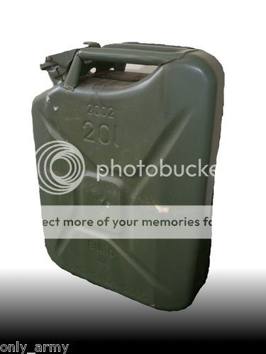

I'll second Sam's comments about using a Mister Funnel. For my money, I think that all of the plastic gas cans are worthless. I live in SE Florida [hurricane central]. Every summer, I stock up on fuel, to be saved for emergencies. Fuel is purchased in early June [Sta-Bil added] and if I'm lucky [no hurricane] the fuel is used in October.
It has been my experience over the past 15 years that plastic gas cans [stored inside] can not be relied upon to stay fuel tight for that period of time, in 90+ degree heat. The best gas cans I've found are old [mine are 1969 to 1972 vintage] surplus NATO military 20 liter cans. I paid about $13 each for mine at a military surplus store.

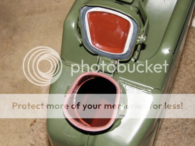

As old as they are, the red interior coating is still intact. The E10 fuel has not harmed that coating. They have the most positive lock on the lid you will ever see. They absolutely do not leak liquid or vapor. I found the photos below on the Internet, as I never took any photos of mine. The one in the first photo is a 2002 model. My 30+ year old cans look just as good. These can be really pricey, unless you are willing to hunt for a good deal. They are definitely worth it. My plastic cans now go unused.
Lid latch detailed below
Red coated interior clearly visible
High quality nozzles are also available for these cans. The nozzles have the same locking feature as the lid.
