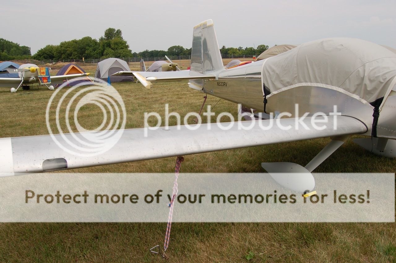

Pete welcome! I have standard fuel tanks but would love to have full leading edge tanks like these. It's a lot of extra work you have to fabricate your own leading edge skins.

Pete, there are the Safe-air tanks that give you another 10 gallons or so, if that's enough. They're filled at the wingtip, under a flip-up door you install and consist of an aluminum tube that slides into the holes in the ribs.
Here: http://www.safeair1.com/fueltanks/rv9ertanks.php
