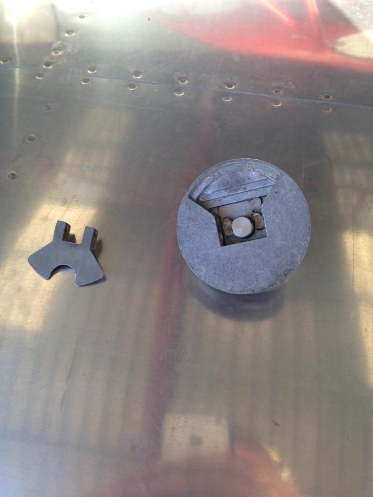

During my preflight this morning, I had this happen:
Fortunately, my hangar mate has a pair of RV7 wings stored in the hangar. I have to say, it was a bit difficult mounting those wings to my 9 but that solved the problem! RIM SHOT!
But seriously folks, I borrowed a cap from his wings which saved the day.
Has anybody ever had this happen to them? Any tips regarding prevention?
Short of spending bucks for an upgraded cap from Vans, which involves bonding, I would think the best bet would be to order the same type of cap plus a spare. Thoughts?

I just ordered the fancy caps from vans and have unused original ones. Make me an offer?

Happened once to me. You can fix it with a new roll pin. I try to keep the o-ring lubed, and not set too tight, and the whole thing operates a bit smoother. I carry an extra fuel cap just in case.

I also had this happen to me. Ordered extra roll pins from Vans, but in the mean time I cut down a properly sized drill bit shank and use that. Sorry, I do not remember the size of the drill bit.
