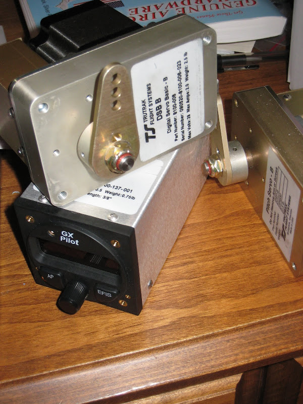

Brian,
I'm sure you did this, but since so many are following this, does the new TT kits come with this SB? I installed the screw retainer on both of mine.
http://trutrakap.com/forum/attachmen...5&d=1276108555

My servo's have a nylon locknut on the output shaft. I think they redesigned them a while back...
Picture from a post made by Paul Dye:
