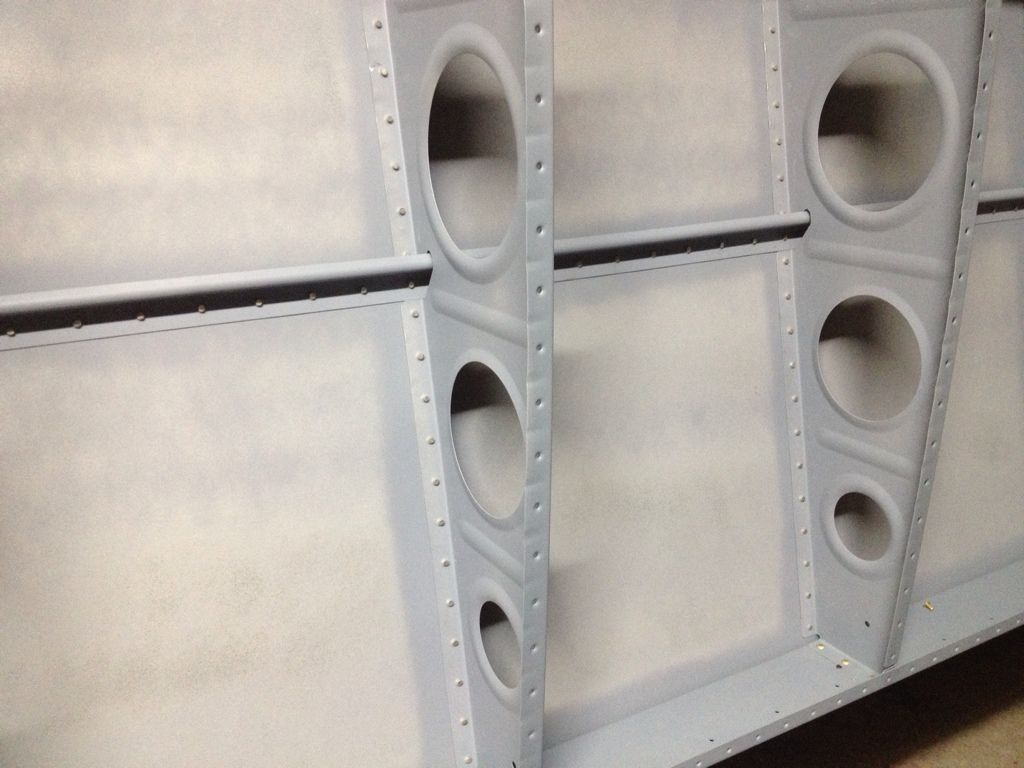

I primed the ribs and all mating surfaces thoroughly, then sprayed a light coat on the wing skins.

Tom, do you have a jeweler's loupe or some sort of magnifier you could use to inspect the light spray job? I find myself somewhat skeptical. I'm assuming a spray job that looks light or thin might actually just be partial coverage. If the area of the skin that has light coverage is really 40% primer, and 60% bare aluminum, is that really helpful when it comes to protecting from corrosion?
If my skepticism is unwarranted, someone please set me straight.
