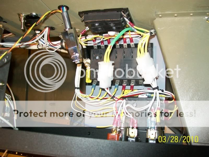

Andy,
Here's what I did and it worked out fine. Maybe not the best picture but the two busses on the panel are main and avionics. The third fuse block is the battery buss and I mounted in on the sub panel just above the other two. On the tipper that seemed to work out the best for me and the way I routed wires. If I had it to do over again, I would have used 1/4 turn fasteners to hold it up rather than screws.
Found another picture if it helps:

The problems I've seen with hinged fuse panels is by the time you get all the wires installed the bundle has become quite rigid, consequently the panel does not like to pivot without undue stress on the wires.
Walt Aronow, DFW, TX (52F)
EXP Aircraft Services LLC
Old 02-08-2013, 09:52 PM
az_gila's Avatar
az_gila az_gila is offline
Posts: 10,011
Smile Allow for twist
I agree.... so I routed all of my incoming power wires in a single bundle with about a 9 inch straight section and two Adel clamps. If I keep the closest Adel clamp a little oversize I plan on letting the straight length of the bundle just twist over the 9 inches.
We'll see how this works out, but it looks OK so far with over 50% of the wires connected - the rest are in process....
The 2 inch spacing is OK since all of the 1/4 inch tabs are at a 45 degree angle or so. The wires running in between the two blocks can be made into a single bundle.

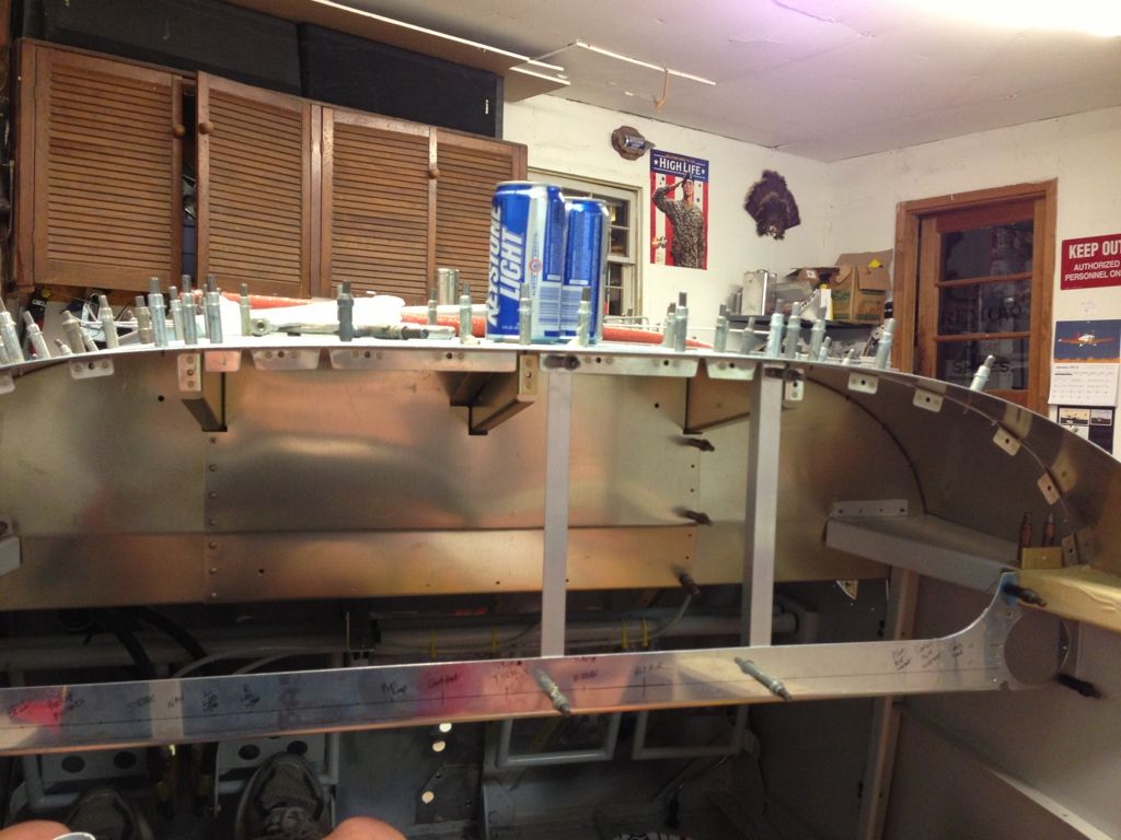

Here's a shot of my panel layout, what about making a solid floor behind the co-pilot side of the panel and mounting the circuit breakers there and accessing through a removable front plate. I don't plan on putting any instruments on the copilot side so the size in the pic should be the size of the access panel. The pilot side will house the GSU73 for a 2 screen G3X.
