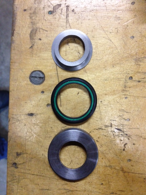

Today I modified the tailwheel assembly to use a sealed angular contact mountain bike headset bearing. Machined some spacers and cut 0.400" off the bottom of the weldment with my mill. The cup is not pressed on or part of the weldment, the three pieces just drop onto the shaft and are sandwiched between the weldment and the fork. Just pushing the airplane around the hangar it makes a huge difference and the side effect could be that the airplane could easily weathervane if its not chocked or have the parking brake on. I like it.
Bearing, available on Amazon:
http://www.amazon.com/AheadSet-Ahead...ords=HSS20133K

Posts: 1,156
Default bearing grease
Almost didn't dare write that title, for fear of starting yet another "grease war"...
But. I have several bikes (another weakness of mine) with that type of bearing. In my experience, the grease installed by the manufacturers isn't the greatest. Even on my road bikes the stuff seems to find its way out quickly despite the seal, particularly the bottom bearing. I've taken to popping the seal out with a dental pick before first use, and forcing in (fingers work great) what ever red synthetic grease I have lying around. The bearings last noticeably longer for a couple minutes work.
