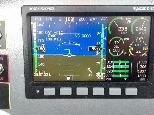

Originally Posted by RV10inOz View Post
?.....but to be fair, you are operating at a different MO than the normal cruise. It would be interesting to see what you get operating at a DA of say 8-9K and WOT and 10-20LOP.
By the way your % power is wrong, some engine settings are not entered right. It should be showing about 79% power......
Ok David, I had a few minutes before work today and gathered some new numbers. This is a normal cruise set up for me, actually if I'm going somewhere I will be higher to clear the mountains. But for 8000DA this is about right. I don't know how LOP I am, as I just lean the ol fashioned way. Pull until rough and then smooth it out. My engine gets rough, then just seems to quit soon after.
WOT, 2450rpm, 9gph (when I'm at 11500 I'm <8gph)
I haven't looked into my Dynon %power settings yet, but think it is fairly close in the above pic, based on the formula you gave me.

  #70
Old 02-09-2013, 05:37 AM
pierre smith's Avatar
Location: Louisville, Ga
Posts: 7,840
Default ??
Does the D-180 not have a "Lean" mode? With my D-100, push the "menu" button (second from right) and then "more" and you'll see a "Lean" button. Pushing this allows you to see your EGT climb to peak and then the big numbers disappear and a -15 or so. will appear, indicating degrees lean-of-peak.
