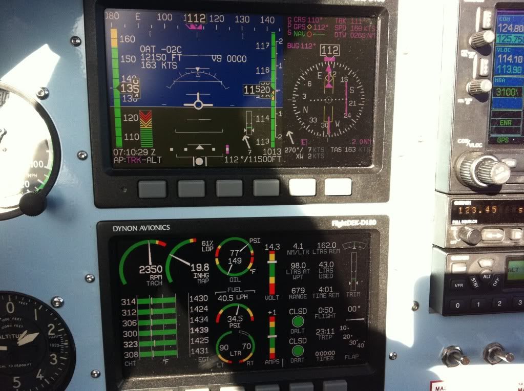

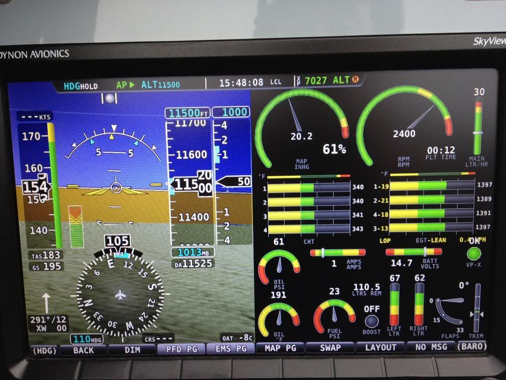

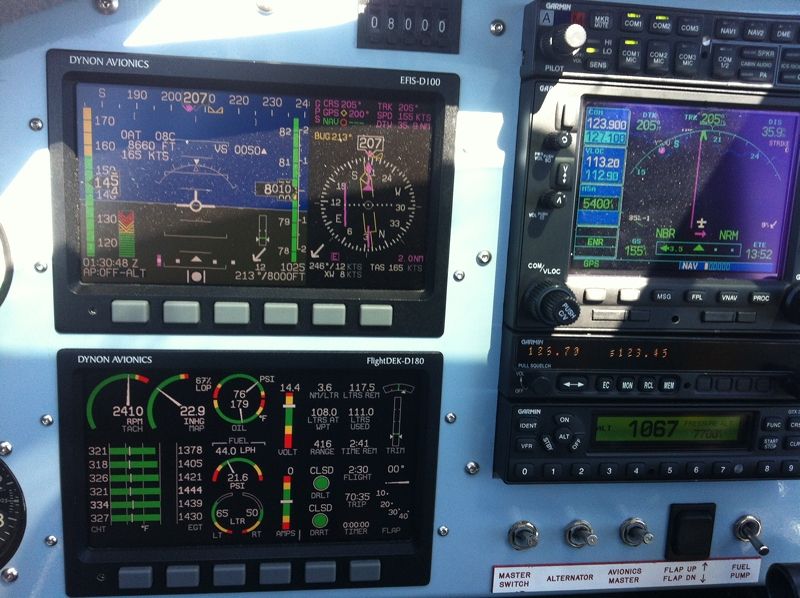

Originally Posted by Bastien View Post
Here are my RV8's with the plenum.
I can't say anything on the RV7 but at least on (my) RV8 it works pretty well. Not to hot/cold and CHTs are really close.
Never had any issues for the moment from 90F to 10F OAT.
I am sure baffles work well if you pay attention to the leaks (as you would also do with a plenum)
Note: Mike do you have the ECI cylinders with the tapered fins? If you have them and did not do any mod on the cylinder baffle, it could be an issue resulting in high CHTs.
Exactly my point. I would class that as a Plenum FAIL.
Sorry if you feel upset by that harsh comment but lets be real here folks, the OAT is -8 deg C and at 61% power and running LOP !!!!
That should be CHT of around 290 d F.
You have proven my point exactly.
You are confirming exactly what I see here. Try that in Australia or the southern USA.
Here is +8degC OAT, and 67% power LOP
or how about +2deg C at 63% LOP
How about -2dC at 61% power and before I fixed a few things
and last one for tonight, +13dC, 68% power and check out the CHT
I understand my post above and this one will hurt some feelings, but you can have 100 opinions and beliefs, all it takes is one shot of real data to shoot them down.
