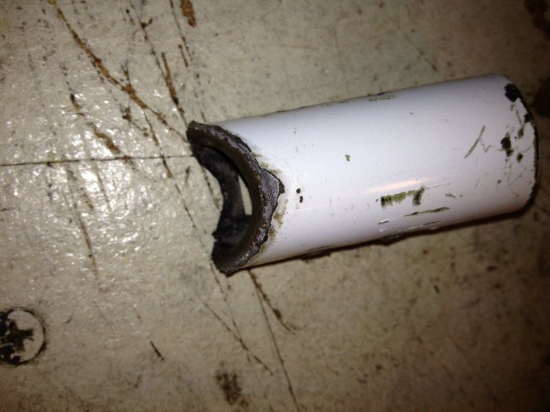

I agree, it's very rare occurrence and that weld should handle the load without worry.
Here is a possible future replacement.

And here is another possible replacement: http://www.flyboyaccessories.com/sto...roducts_id=413
We use a high tech plastic bushing. Simple and superior to the standard bronze bushings. We have been supplying these for over 5 years now. Long wearing, easily replaceable, and no known problems as long as you don't powder coat the part and heat damage the bushing!
In the photos the area that failed in this instance look identical to the construction of the part that you're referencing.
Dave
They have the same joint as the Van's one that failed. Really, really rare to see this. I have never seen or heard of one failing here.
The tailpost upgrades are offering a promise of less maintenance, so they are just trying to make people aware there are other options. This person may be in the market for a new tailwheel post if he does not repair this one. Marketing opportunity.

Similar break last November during landing

Many of us do a dye penetrant check on the lower engine mount/gear leg area. Perhaps checking the tailwheel mounting socket would be a good area to inspect once in a while?
Here's one from Grainger that should work:
dye penetrant test kit
You might also take a look at your tailwheel mounting socket welds. As Dan Horton pointed out, these are thick walled steel parts. The weld beads should be substantial. Here's a good example: http://www.flyboyaccessories.com/sto..._image&pID=413
If your welds look puny, it is a very easy thing to fix by re-welding, or even adding a triangular gusset for "belt and suspenders" protection. I don't think the gusset is necessary if the weld is beefy though.
If you decide to re-weld, try not to overheat your bronze bushing. Stuff a hot dog into the hole to soak up the heat. When you're done welding, the hot dog will be cooked. Lunch is ready. Enjoy.

Rewelding will shrink the ID by a considerable amount. Usually when welding stuff like this if it can't fit back in the jaws of my lathe I set my mill up with a boring head/bar and shave a few thousandths off the ID to true the hole again.
The bushing should be pressed out to reweld. If its an oillite bushing have fun welding if its still in there, they tend to catch on fire readily.

If a welded socket makes you nervous try an Aviation Products tailwheel. Likewise, there's nothing to stop one of our vendors from making aftermarket sockets from a CNC'd chunk of 7075 biillet.
