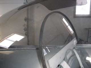

RV8 Wind draft Buster stops draft & reduces cabin volume for better heating
Lexan sheet 0.065 cut to close off canopy behind rear seat
MD weather seal part number 01025 black Marine and Automotive all-weather EPDM rubber
It’s a double D self-adhesive seal and I wrapped and glued one D on each side of the 0.065 Lexan
But with the two Ds approx. 0.25 inch above for compression sealing. Then the lexan is velcroed for quick removal and installation.

can't get to the link and interested in seeing what the words describe as we have a draft problem with our -4.

Great idea! Danny King devised a similar solution to the problem, except that he put a barrier connected to the canopy frame tubing, sealing off the area. It's a permanent fixture. I like that yours is removable.
