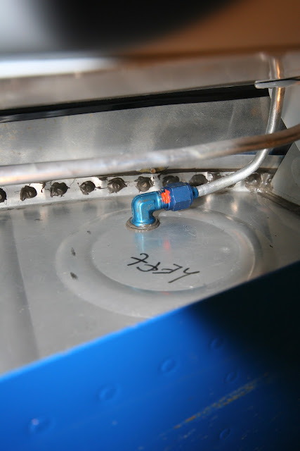

Hi,
The vent comes out of the tank via a 90 degree fitting which should be facing forward as per plans. The gap between the fuselage hole and the fitting allows enough room to bend soft alum tubing to meet the 90 degree fitting.
There are several photos on my blog where the tubes can be seen bending back behind the front tank mount. Sorry the photos were not taken to show this but you should get the idea from them.

Originally Posted by WAM120RV View Post
Hi,
I looked through the blog and didn't find the picture you mentioned but I get the idea. Thanks.

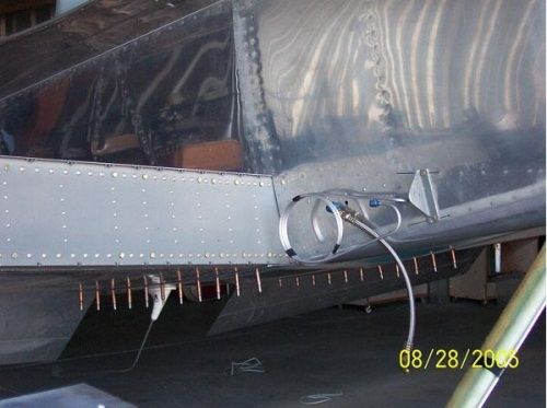

Default Picture
Originally Posted by hcccs View Post
I am installing the tank vent on my RV-4 and trying to figure out how to connect the AL tube coming out from the fuselage with the fitting on the tank. When measuring I find that there is 1-2 inches between the two when the tank is put in place I and don't understand how to connect the two any easy way if at all. I built everything as per plans and now I find it doesn't work - or so I think. How have you RV4 builder done this?
Not sure if this is what you are wondering about ??
Marc DeGirolamo

Old 01-09-2013, 12:00 PM
hcccs's Avatar
hcccs hcccs is offline
Join Date: Apr 2008
Location: Stockholm, Sweden
Posts: 164
Yes, it is. Thanks for the picture.

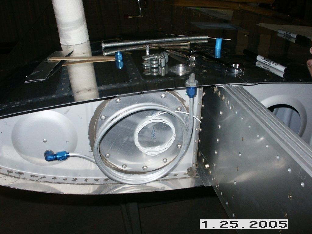

Default What about other vent options ?
Is the vent option in the picture Ive attached better or worse ? To me it looks easier to implement.

Default coiled vent issue
I am always a fan of good ideas,but I am wondering if the coiled vent has been in operation yet? The vent system per plans puts a point in the loop that runs up the bulkhead much higher than the vent end in the tank.This prevents siphoning in certain attitudes,such as slips and sloped parking...per plans is easy to do, and the root connection is not that hard.
Bill E.
RV-4/N76WE
8A7 / Advance NC
Old 01-09-2013, 06:28 PM
Ironflight's Avatar
VAF Moderator / Line Boy
Location: Dayton, NV
Posts: 12,243
I's in operation in all of the F-1 Rockets out there in the world, and in a number of RV's. I would say that it works "adequately" - has not given us any problems in our RV-3 yet, and if you take a look at the even simpler RV-10 vent, you might be surprised at what you see....
