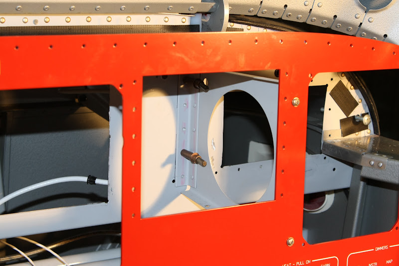

I want to get all the heavy cutting, grinding, drilling, etc. out of the way before the avionics even come out of the box. Then do a good vacum job on the interior to get rid of the mess I have made.
So last night I started working on the panel support ribbs.
The old panel support had three ribs. Two on the pilot side that were riveted in non-standard locations and one factory one on the co-pilot side.
I had to drill out the one on the left and the one on the center and then cut the one off on the right. I also drilled out all the rivets for the old map box braces.
Here it is all clean and full of holes like swiss cheese!
So then I discarded the pilot side one and added a new piece of angle to the one I cut off from the co-pilot side and re-mounted it to the pilot side. I moved the center one to the co-pilot side. The new panel will not have a third one. I used the Red panel to locate and drill the new locations for the ribs. Keep in mind that this Red panel is now a mock-up only panel because I do not like the Red color mismatch with the fuse. I have a new Grey one being built that will become the final panel.

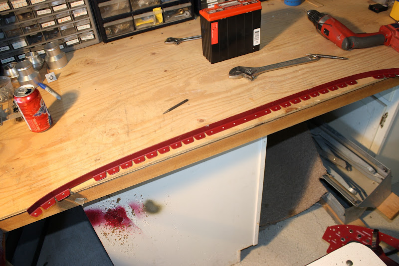

First thing today was cleanup and cleanout time of the cockpit. I pulled up the carpet and cleaned all the wires, connectors, tools, screws, washers, nuts, bolts, parts etc. etc. etc. out of the airplane. It was a complete mess. I got it all cleaned up and moved on to making more of a mess....
First thing today was to remove the canopy. I hate putting it at risk but it just had to be done. My buddy that helped me who is also an RV builder and I both commented on how crazy I was for even messing with the canopy let alone taking it off and laying it in the floor. Hopefully it won't get damaged during the process.
Looks weird but it really opens up the work space. I needed to do some work on the seal in the front. The work I needed to do could not be done with the canopy on there. Bonus is that it is out of my way....
Got out the Dremel and did the cuts of the seal shelf that I needed to do. If I were building another tipup RV, this area would be built very much differently!!!!
Fabricating a new angle to go along the bottom of the panel.
All drilled in place.
Some reliefs need to be cut to make room for components of the panel.
Mark em and provide some relief.
All the reliefs cut out and blended.
Shot from behind....
Drilled out all the rivets holding this angle to the old panel. Not about to remake that thing again!!!
All removed and ready to fit to the new panel.
