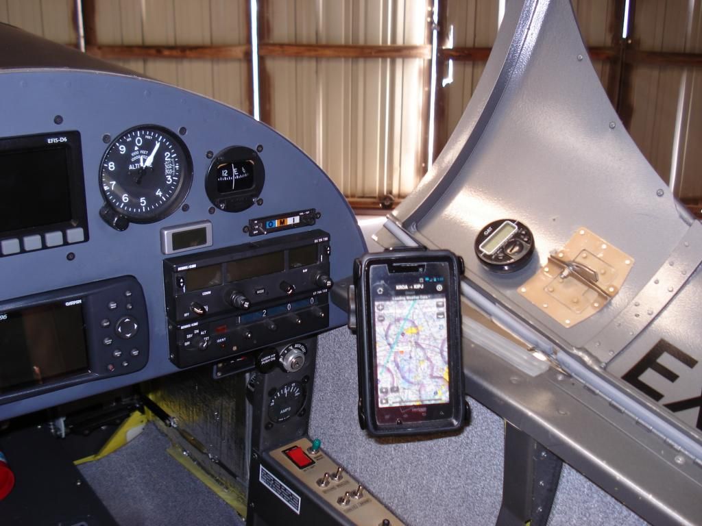

Hello my name is Stan and I’m a recovering utility category spam driver.
Admittedly, I yank on my deprived girl (RV-4) like she’s a C-152 because I don’t have experience identifying G-forces (or an instrument to do so.)
While shopping for a g-meter I happened to think that the accelerometer in my phone (Droid Razr) may be just as accurate (without having to saw another hole, wire the device and spend the $$.)
Does anyone have experience flying w/a smart phone G-force app? Anyone happen to have a hard mounted phone and a G-meter in their dash that could run a comparison? Or perhaps a way to verify the device readings?
The attached picture is my setup of Droid Razr w/Otterbox Defender case w/Ram mount typically used for the Garmin Pilot software.
My end goal is to expand my flight envelope w/greater pulls while staying well within the design requirements. Advice on how to get there is greatly appreciated. Thanks in advance.
Stan Smith

I've written a couple of Android applications that use the g-meter. It possibly varies phone to phone, and there is some conversion for orientation that is up to the app developer. So you'd want to test a _particular_ application against your plane to know for sure.
One of my applications was used for lab testing of a vehicle and the readings were within a percent of the expensive instrument we used to use.
But once you've tested phone X with app Y, I'd trust it just as much as the g-meter in my panel.

I tried using the g-meter app for iPhone/iPod on my iPod touch, but gave up pretty quickly; it was too sensitive, i.e. completely undamped, and the result was it constantly oscillated between -1 and +2 g's in relatively smooth air, flying straight and level. Ended up buying a used conventional gauge and mounting it on the center windshield support and am much happier.

When I was learning aerobatics I got used to the "feel" of 2G with 60 degree banked turns. A 60 degree banked turn at constant speed and constant altitude will require 2G.
Similarly, a 70 degree turn will give you 3G, and 75 4G. It's harder to identify a 75 degree turn accurately, especially considering at 4G it's unlikely you'll be able to maintain speed. But initially it will get you an idea what the G-forces are. And may be enough to "calibrate" your Android.
I find my iPhone to be usable if I have a "damped" G-meter. Good for holding constant G, but not so useful due to the lag for doing actual aerobatics. Turn the damping off, and you have the same problem reported earlier, it bounces around too much.

Great thread I've been eyeing g meters too but overlooked the iPhone because I thought it would be too inaccurate.
You mention you have a ram mount, what kind exactly and how did you mount it ? Thanks
