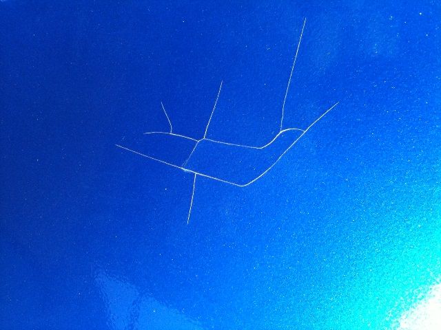

Yep, here is a sample of the cracks I got in my nice new paint from the gelcoat. And a photo of the extensive repair. The repair on the aft end was in attempt to hide the darn metal rib better. Hopefully these new tips will be better.
I don't know if it is relevant in this instance, but this is one of the reasons I am not a big fan of two stage paint systems on aircraft.
Clear coats (particularly if you are not buying the real high dollar ones) are not nearly as flexible as many of the popular paints are. Clear coat cracking, because of flexing on surfaces that aren't real stiff (like some areas of wing tips) can also be the cause of this type of issue.

most tips are VERY wavy and have spider cracks here or there from Van's, they say deal with it.

Actually I did use the high dollar PPG paint and clear. The cracks were in the gelcoat, not just the paint. The repair consisted of grinding the cracks all the way down to the glass to get rid of them. But with that said, I think I'd go single stage next time. Base/clear takes too much time, too much expense and too much weight.

We been sanding the RV-10 wingtips for the last several days. Way too many micro cracks in the gel coat. I couldn't see them initially until we primed. We basically had to sand ithe gel coat off and start over with a sanding primer to make things look right.
