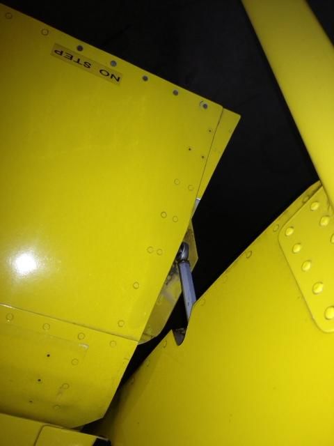

Ron,
My flaps are also up tight against the bottom of the fuselage. Although one side is tighter than the other side. I hear that is typical. Perhaps you should double check the wing incidence to make sure you drilled that critical hole for the aft spar connection in the correct spot. That could easily explain the difference but let's hope that's not the case.
When I was at the factory the other day I noticed that Van's trimmed the end of the flap skin off just aft of the connecting rod. So the factory RV-9A does not have an overlap on the back half of the flap and there is actually a gap. It got me wondering if I did it right by leaving my skin with full overlap. I haven't had a chance to look at the plans since. You'd think it would be best not to have a gap and I'm not sure why Van's trimmed theirs.

Here's a photo of the factory RV-9A flap end. You'll notice how the bottom skin is trimmed off past the rod bearing. Has anyone else done this or did I miss that detail in the instructions?
