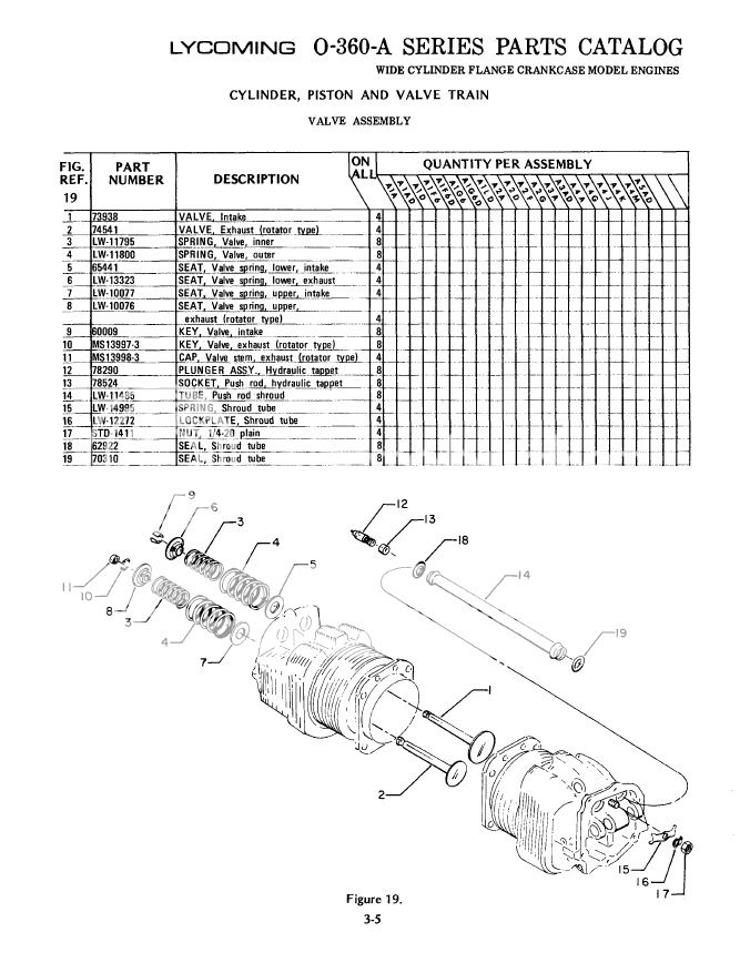

Originally Posted by ColoCardinal View Post
I called ECI and they were very helpful. They said they would be sending new retainers, lock tabs and gaskets the same day. Kudos.
FYI: the engine was assembled by AeroSport in 2010 and they did use one heavy washer behind each of the retainers. So, what do you guys think? Should I reassemble with the washers as delivered from the builder or without per the manual or use the fit each part with "little pressure" method?
Yes Sir...
Look at #19 in this pic.
Photo of exploded diagram at http://i48.tinypic.com/30skftf.jpg
Reiley
Retired N622DR - Serial #V7A1467
VAF# 671
Repeat Offender / Race 007
Friend of the RV-1
  #90
Old 12-04-2012, 07:52 PM
az_gila's Avatar
az_gila az_gila is offline
Posts: 10,011
Exclamation
Originally Posted by LifeofReiley View Post
Yes Sir...
NO SIR
I believe the picture you linked to is generic for the narrow deck cylinders.
Note the end shape of the pushrod tubes - machined not formed
Note the TWO springs in your diagram.
Note the square shape of those springs.
It's not for the much more common wide deck Lycomings....
