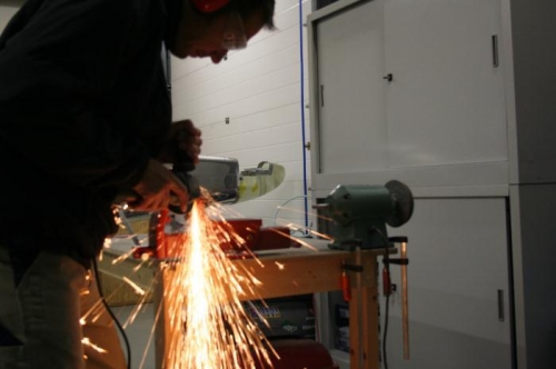

Step 32: Add bevels to the four corners of the U-1202 Outboard Main Gear Attach Brackets.
Has anyone done this yet, and if so, how? My first inclination is to take the grinding wheel to it, but my first inclination is almost always wrong.
Problem here is that I don't have a Plan B.

I taped off the 1/4" and used a grinding wheel. I polished the corners with a file and the scotch brite wheel.

A somewhat course belt (60 - 80 grit) on a belt sander will work quite well (if you are not in a huge hurry). Have a container of water to dip the parts in occasionally to keep them from getting excessively hot.
