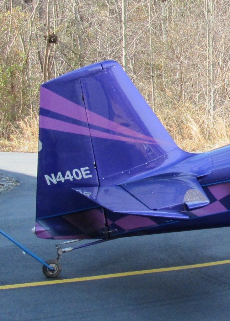

I will attach a photo of the rudder on my RV6. The aircraft was built by Robbie Attaway and has a balanced rudder. It is a small tailed six. I believe it is similar to Dave Anders. You can visit his website for contact info at Attawayair.com. He may be able to help you with the design.
George

George, Thanks. That does indeed look like Dave Anders tail. I appreciate the info. Mike--
