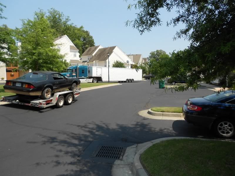

Yesterday was a big day in the build of N-251WM. The delivery truck arrived around 1500 EDT and the first trick was figuring how to actually get the truck into the end of the road where I live. It was a tight squeeze but Partain's guys are pros.
I was able to enlist my minions ... I mean a crew from work ... so we got to work unloading the truck and surprisingly there was very little to actually unload - 2xwings, a fuselage, and a big box.
One of the best things I did was to have the wing cradle and fuselage stand (both on wheels) already built so it was easy to just transfer the structures from the truck. Thanks to Colin Peterson, WingsOnWheels (RV-6 build), for the pictures of his cradle/stand and the design - it is perfect for the tight space I call my garage. We did do a test fit to make sure it would all fit (barely) before we got to work on the inventory.
As we unloaded the fuselage that was full of parts, I found a long wood plank (which is not on the inventory) but my helpers certainly found a good use and simulating hand propping while I tried out the cockpit.
I am sure the inventory will take a few days but the excitement is just beginning with my first "RV grin."

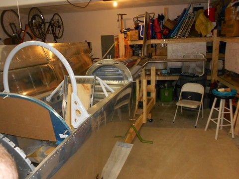

After a long break for my kids summer visit, I got back to work. Lots of days at the beach but I did manage to get my boys to help deburring the thousand holes on the wings. I think they have a future in aircraft manufacturing.
The nice part about the fuselage is the ability to work on various subassemblies without having to necessarily work in order. The seats went together nicely although I had to determine if the rear seat tabs go on the inside or outside. The plans show it both ways and a quick call to Van's confirmed - outside.
While working on the seat hinges, I jumped ahead to the cockpit floor ... something about actually seeing progress breeds even more motivation.
From the floors I moved on to the rear baggage area.
It took almost an hour to deburr all of the edges on F-834-1 (big rear baggage tray). I discovered micro files and I'm not sure how I made it this far without these tiny gems.

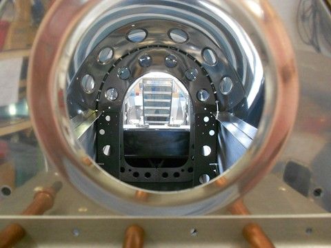

I did pause for a moment Friday when I finished the rear seat bulkhead assembly. I turned it over to take a picture and the resemblance reminded me of the Lunar Module. We lost one of our pioneers last week and I thought it fitting to have this reminder on the day we remember Neil Armstrong.
