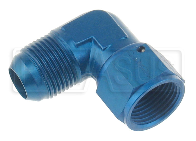

3. I did not have a problem installing the fuel pump were called for on the RV7 but if I were to do it over I would move it up slightly to get more room for attaching the fuel lines.
Or mount the fuel pump a bit lower and use one of these fittings at the IN of the fuel pump...
