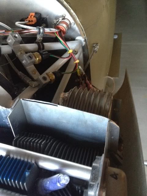

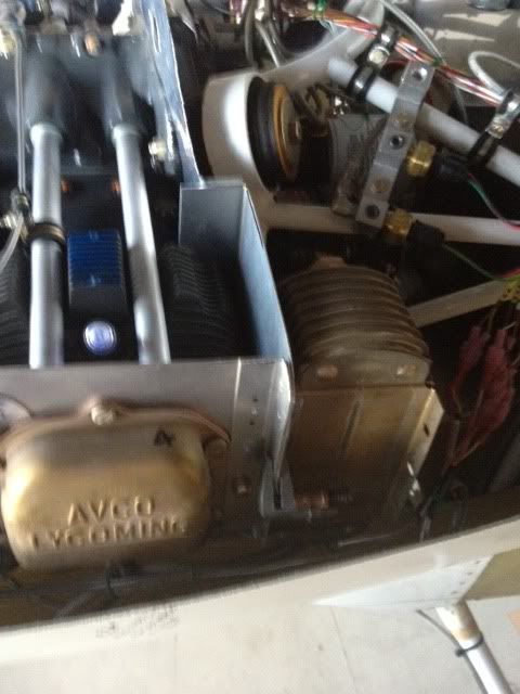

This is a photo of another builders oil cooler solution which I copied exactly. It has a plenum so that air can reach all of the cooler fins.

i have 500 hrs on a very similar type of setup I live in michigan so made a cover to block front opening into plemiun for winter but had to pull cowl everytime it warmed up. got sick of this and in vans catalog is a cover for the oil cooler that you can move with a cable from the cockpit. I put this between the plenuim and the cooler works great. In the picture you see the side and back of this baffle is reinforced with thicker material. at the back of the engine in my o-320e3d is a spot towards the center of the engine were if you extent the thicker plate at the back of the baffle you can add another bolt to secure this plate to the engine. I was concerned about the weight on baffle so looked for every way to beef up this mount.
