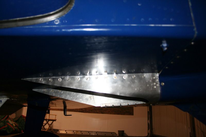

When Jeanine and I built our RV-6A 1996-2004 our intention was to race in whatever cross country air races that came up. Usually one per year until SARL was created, now we have over 20 per year (www.sportairrace.org). With that focus during the original build, I contacted the manufacturer of the best looking "in the wingtip" antennas. When I told him that I fly IFR he told me that the antennas were intended for sport flying applications and he would not recommend them for serious IFR flying. That was a NO GO decision driver for me.
I could make cover plates for all of the external antennas, two communication, transponder and marker beacon (I already take off the navigation elements by unscrewing them), remove them for racing on site and reinstall them before flying home. The 12" stock wing tips have been replaced by a 3" streamlined tips of my own design and the performance of the com antennas placed in them for turn and finish line calls would be further compromised. I would have to route a coax to at least one wing tip and change the RF I/O connection to the race only coax someway (change connections, coax switch, etc.) disable the transponder (you don't want transmission attempts into an unloaded output, maybe some FAA problems there as well - depending on race location perhaps). Still, if I run out of more promising and less compromising opportunities the passive drag of external antennas will be kept in mind - I look at them and wonder each time I wash the belly.
The speed differential between out RV-6A and the current RV Blue race leaders is from 3 to 9 kts and I think I am going to have to deal with the thrust member of the speed equation to overcome that. Two of them will be in the AirVenture Cup Race next Sunday and we will see what we have accomplished so far. I am hoping this engine cooling air outlet mod cuts into the margin.
I completed a trial "final installation" of the new one piece cover this morning at 05:40 and there are some problems.
The 0.040" 6061 0 material I had available and used, is very soft. It is just a little harder to form than sheet lead so it shapes nicely but its softness causes mounting problems. I knew this from the 0.032" 2024-0 material used in the development cover. I planned to drill large mounting holes and use #8 hardware with dimpled washers to provide more distribution of the fastener head compression but I went too small at 1/4" dia and the washers are not all flat because of imperfect hole alignment. I plan on removing it today, increasing the hole size to 3/8" like I do on fiberglass and plastic parts installed with dimple washers and see if that works. If that is not satisfactory I will go to harder material for a new cover and cure the problem that way. Since I plan to leave for Mitchell, South Dakota for the race Friday morning there is some schedule pressure so I guess I had better eat, get cleaned up and head back to the hangar.

The one piece cover is reinstalled and the dimpled washers are sitting the way the should. I would have liked to see if there was any effect on speed from the cleanup but I'm out of time. I've got a lot of prep work to do before flying to Mitchell, SD Friday fot the 2012 AirVenture Cup race - one secret weapon - so no more effort on the cooling air outlet fairing. I may test it later just to get a new baseline but I think this one is done.
The secret weapon, well it is a strategy thing - tell you later Alan.
Bob Axsom
P.S. I'm calling this configuration speed 183Kts speed which is 1.4 kts less that I got one time in testing a while back so it is hard to claim an improvement in performance. I did two tests in this series (20 and 21) with no fences, no covers and no bumps which yielded 177.6 and 178. 8 knots respectively for an average of 178.2 KTAS which would indicate a 4.8 kt speed gain but the three long angle mounting rails were riveted to the fuselage already and were exposed to the air in tests 20 and 21. S-o-o-o-o, conservatively I'll take the pre-mod baseline speed as the average of the 184.4 and the 182.2 or 181.3 kts. That still yields a gain of 1.7 kts. I'm happy with that. 04:30 and I'm on my way to the hangar to do race prep.

Default 7 Degree NACA Ramp
I have spent many an hour trying to locate the source study for the sugggested optimal NACA exit ramp slope to be 7 Degrees. I can't find it. Since it came up in this discussion I thought I'd ask here.
Does anyone here know the source and have a link to it?
Thanks in advance,
Ned
Originally Posted by rvmills View Post
Some very thought provoking discussion! I know Bob is gearing up for the Hill Country Air Race tonight, but this will give him some great post-race reading material...to bounce his results off of!
Comments below:
Paeser postulated the best angle for exit air was at 10 degrees to the free stream...not far from the NACA 7 degrees...though it may be a slightly different concept at work (not sure).
There may be some acceleration of the air on the first half of the bumps, but I would be concerned about separation on the aft side (as you and others have mentioned). There may be some coanda effect, but I doubt laminar flow can hack that angle, and it sort of has a venturi-like look to it. Only down side is the back half of the venturi would expand and slow the exit air...opposite the goal. (more on that below).
Also, I think slowing the freestream air locally would be counterproductive...I know you're talking about makiing the flows more compatible, but it would seem slowing anything in this area would be drag-producing. Just a comment for discussion...this is all facinating stuff!
Dan, I think there is probably some area reduction...at least compared to Bob's previous configuration, without the bump. I do see your point about re-filling those cutouts (though I'm concerned about blocking the exhaust directly and causing odd flow patterns downstream), and I also wondered about exhaust stains on the bump. Looks like it is there, but the swirl pattern may indicate separation or turbulent flow.
My pea-brained effort at a similar concept to what your last paragraph says is pictured below (a mod of a picture I did earlier):
From discussions with Paul Lipps, the coanda radius at the base of the firewall might do the lion's share of redirecting and attaching the flow exiting the cowl. Then the continuation of that curve...a softened version of Bob's current bump, as others have suggested) might maintain laminar flow and continue that coanda effect further aft. Opposite that upper bump, on the lower surface, another bump that forms the front half of a venturi could add to the area reduction and exit flow acceleration. Tuning of the system would mean trying to direct the flow aft without reopening of the venturi prior to the end of the ramp (I think)...which I don't depict well in this picture. I do agree with you that decreasing the down-angle of the pipes might increase Bob's current coanda effect, and might allow the aft part of the bumps in my picture to be more aligned with the belly and the freestream.
My kluge of a bunch of stolen ideas, somewhat applied to what Bob is currently working...all FWIW!
And great work Bob...as always! Good luck in the race!!
Cheers,
Bob
