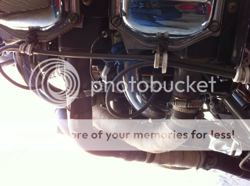

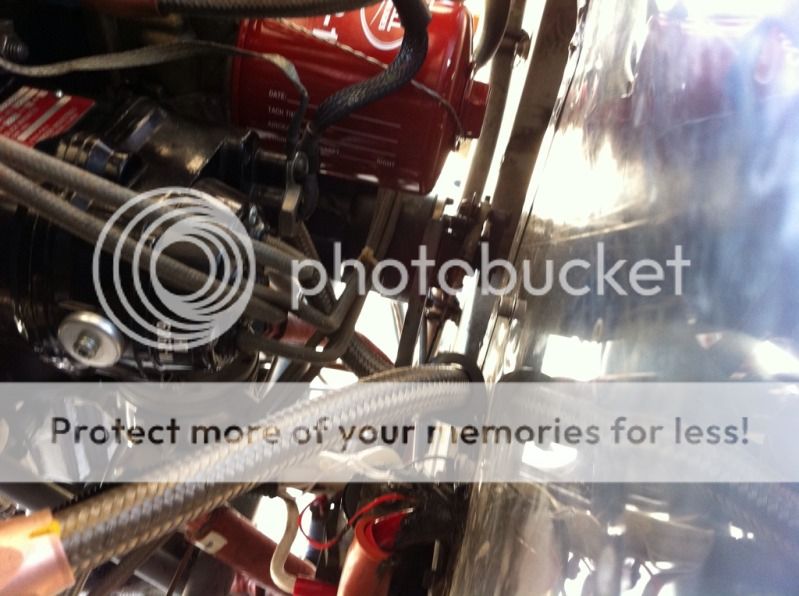

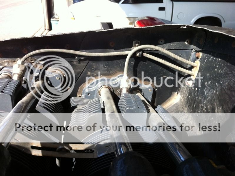

I looked at L-1499B and it calls out T200 tool kit. Been a while since I purchased a harness but $200 at Aircraft Spruce for a few tools does appear like a lot. (Aircraft Spruce had the lowest price that I could find.)
Following are photos of how my harness is routed. Been that way for 15-years. Only slight change going from Bendix to Slick mags.
When I was doing the firewall forward, I have a Piper Pawnee a few hangar down undergoing restoration. I was able to go there and copy some items the way it was done for my installation.
