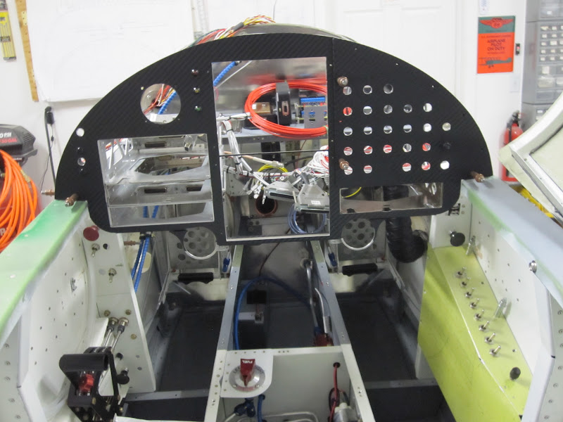

Originally Posted by bkthomps View Post
How are you handling the stick interference and also the brace that typically goes along the bottom of the panel? I am looking to do the same but these are challenges in extending the panel down in the center region there that I am scratching my head over, can you post more pictures of how you dealt with this?
For more pics, look at the Picasa link in my signature.

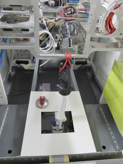

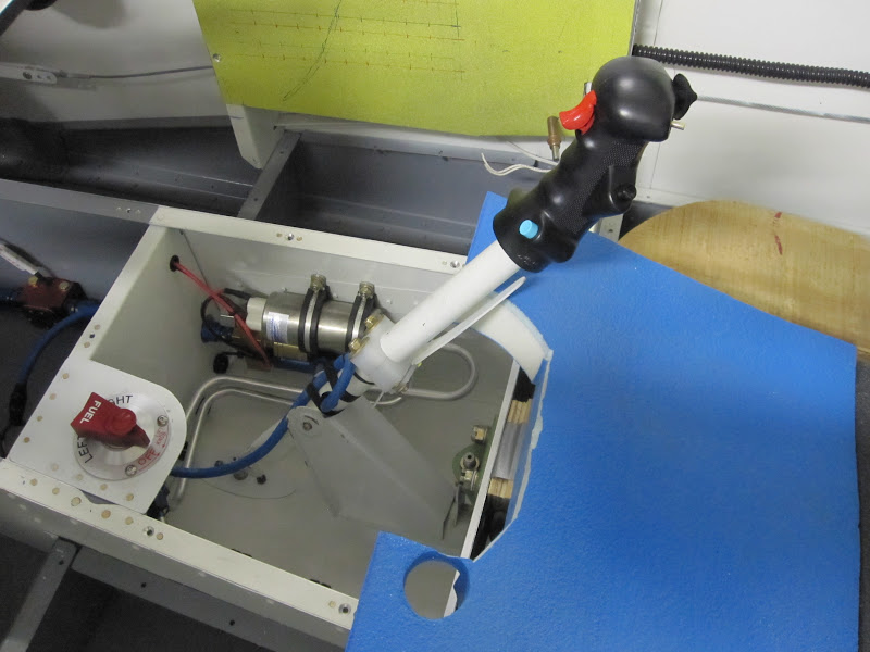

Picture below shows the stick. No issues. The pannel was designed not to interfere with the stick. The red line is just there to hold the stick under the panel.

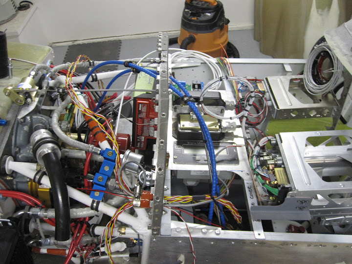

I removed the standard brace and moved the support a few inches closer to the fire wall. It also holds my avionics rack. If you look at the picture below (bottom of the pic, right off center), you will see a 3/4 inch angle that runs up and down (on the picture). Right behind the radios. It is a much much larger support compared to the original.
from the top
from the other side (behing the large multi-color wire harness)

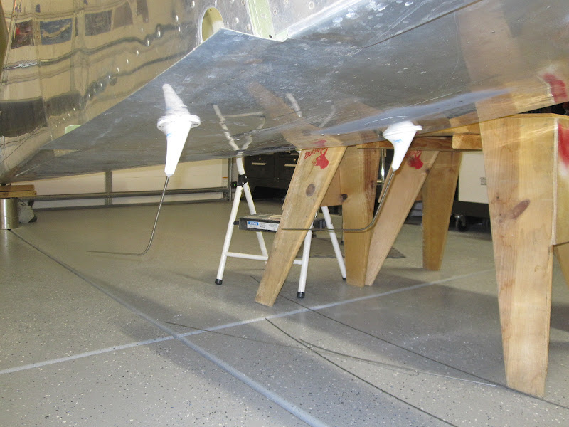

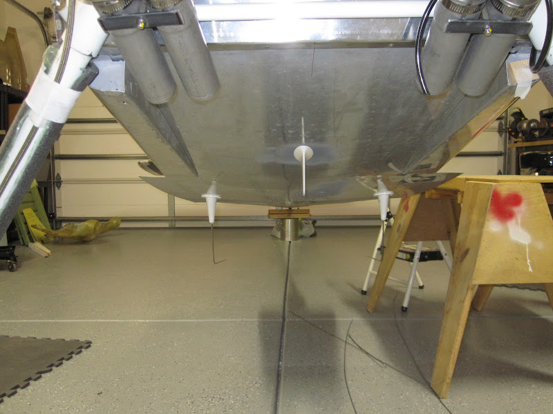

I am way behind on pics. I updated my Picasa albums today. Here are some of the updates.

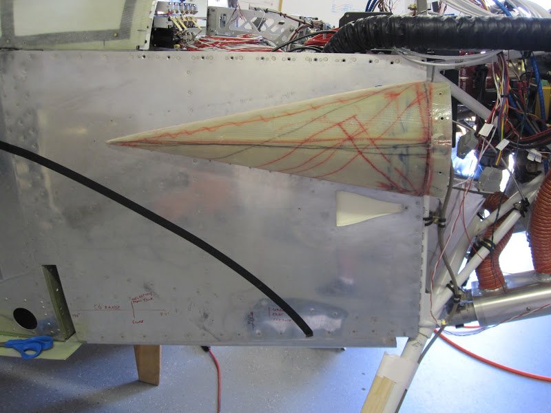

Comm and xponder antennas are on.
The NACA Scoops are on. Like everything else in this build, I had to compromise. This is not the ideal location pressure wise but I ran out of the best options due to internal interferences with other things.

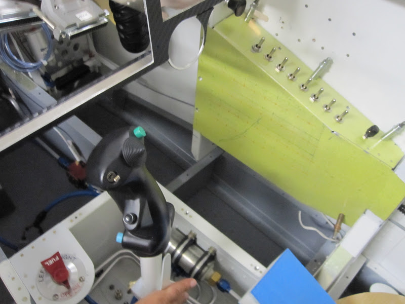

The switch panel and the front stick are in. Still need to wire the switch panel. The blue seat is just there as a sub. It came out of an AV-8B ejection seat.

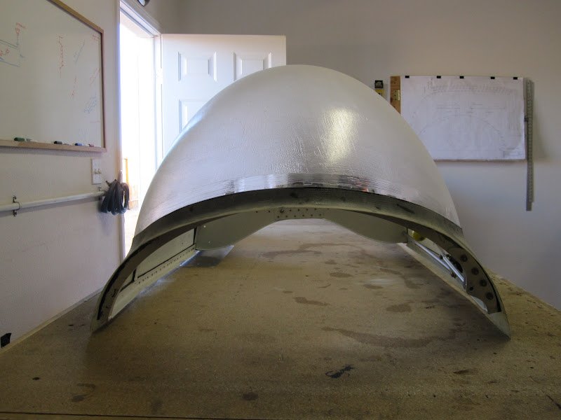

Still updating. Pics are of work in progress.
I removed my canopy for some clean up. I have yet to fill the glass and make it nice. One day it will be done.

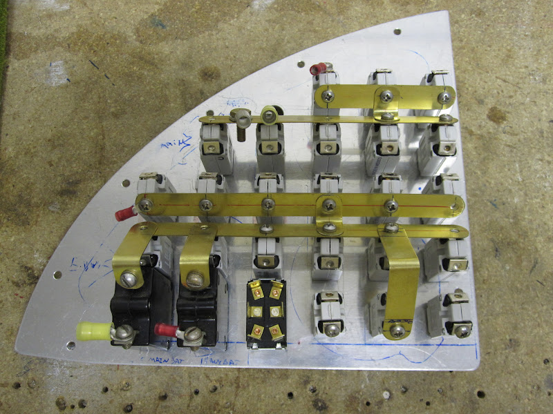

Changed my mind on the standby instruments and replace it with a cicuit breaker panel. I also made provisions on the instrument panel for vents.

Nice -4! And, you will not have any ice on your comm antennas.

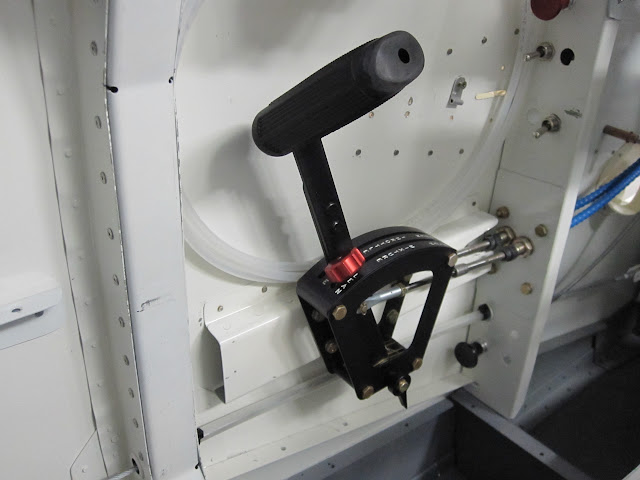

I modified the lever by extending the lever up 1 1/4 inch from the original position. The lever is also bent at approx 45 deg. Parts were provided by Dayton Murdock of DJM.
I started with this and modified it.
here are additional pics.

Nice "Go Fast" lever Axel - believe me, it is probably one of the best cockpit improvements you can make - there is just something that feels right when you wrap your fist around it....

This is exactly what I want to do for my 7A quadrant. Can you provide specifics such as the brand and type of grip used. What if anything did you use to fill the hollow. I plan on putting the flap switch on top of the handle as flaps and throttle are used most and together at landing or take off. Thanks in advance.
