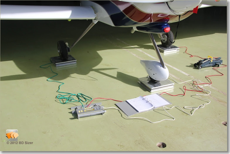

My 7A and most I have seen sit nose high and require about an inch under the main scales to level. I know this won't effect the empty weight, but will render W&B info useless.
It looks by the camber angle of your main gear that you placed the plane on the scales with a jack, if that is the case you should roll the plane back and forth on the jacks to relax the mains. The side loads on the jacks could reduce accuracy. Gene

I noticed from your picture that wing root fairness and wheel fairings are not installed. Are they included in your weight. Also, when I weighed my 9a, I had to block the main gear up about an inch and a half to level the plane. That made a significant difference in the distribution of weight between nose gear and mains. Hence a big shift in CG.
Was your plane leveled for weighing?
I didn't use that jack. I lifted the wing up by my back and used assistance of my buddy
Thank you guys for your kind response to my question and for valuble information! It's seemed I have the heaviest 9A. Probably there is a lot of stuff inside my bird and it's painted heavy with a good layer of lacquer.
Now, I have to scratch my head well to decide what could be thrown out of the plane I don't know...
