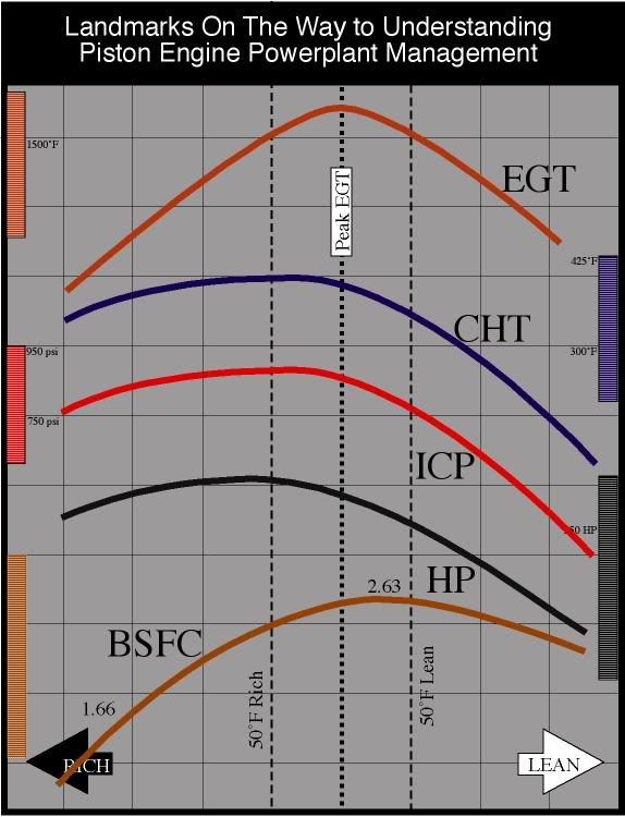

Hi David,
I haven't had the benefits of your APS education so perhaps you could explain the following to me.
Your table above confirms my understanding that HP is directly related to FF when LOP. However I would have thought that rpm is also a factor as there are higher pumping and friction losses at higher rpm.
LOP and Peak EGT have almost the same BSFC and Lycomings Part Throttle Fuel Consumption graph shows different HP at different rpm for the same FF at Peak EGT.
For example for a 160 HP I0-320 operating at Peak EGT, a FF of 8.3 GHP will produce 120 HP (75%) at 2,200 rpm but the same 8.3 GPH also at peak will only produce about 108 HP (67/68%) at 2,700 rpm presumably due to pumping and friction losses. Why would the same relationship with rpm not apply when LOP

Finley,
Have a close look at this graph, courtesy of another thread and APS.
Not sure which graphs you are looking at but this one represents all engines, lawn mowers, P&W radials, and yours.
As for higher RPM losses, this is true, engine losses and prop efficiency all add up, but we are splitting hairs a bit. Pick a nice smooth RPM that works for you. Balance your prop too!
As for LOP, Fuel flow determines HP, there is more O2 than fuel, so hence Lean of peak, thus fuel is the key factor. No spare fuel particles. On the Rich side of peak there is no O2 left so to speak, but ample fuel, and detonation margin notwithstanding, varying fuel flow has very minimal impact on HP. So Mass Airflow is king.
At the end of the day, splitting hairs is not relevant as you can not fly that way nor set all 4/6 cylinders that way.
Basically you have it pretty much sorted By the way, LOP and at 75% power fuel flow should be about 8.05GPH, so 8.3 would in theory at least be ROP, but not a lot!
Cheers.
Lycoming 0-320 Operators Manual Fig 3-10 Page 3-22.
I think you are missing the point I am making. You give a definite fixed figure for 75% LOP fuel flows. I am suggesting the figure is not fixed and will vary considerably depending on rpm. For example, using the above graph, 75% fuel flows at Best Economy (peak EGT) can range between about 8.9 GPH at 2,700 rpm down to about 8.3 GPH at 2,200 RPM. LOP and Peak have about the same BSFC so I assume there would be the same range in fuel flows for LOP. The range is even greater (7.1 to 8.0 GPH) at say, 65% power as rpm can be reduced to 2,000 rpm.
I have a carb engine with a CS prop and run at 2,200 rpm at peak (or LOP if possible) up to a max 65% power and I know from the above graph that 65% power will be at 7.3 GPH so I make sure I don't exceed this FF. However someone with a FP prop that may be running at say 2,500 rpm would know from the above graph that they could have fuel flows up to about 7.75 GPH to not exceed 65% power at peak or LOP at that rpm.
Got my 8.3 figure from the above graph and if my thinking is correct then it could even be up to 8.9 GPH if at 2,700 rpm.
I am happy to be corrected on all this.
