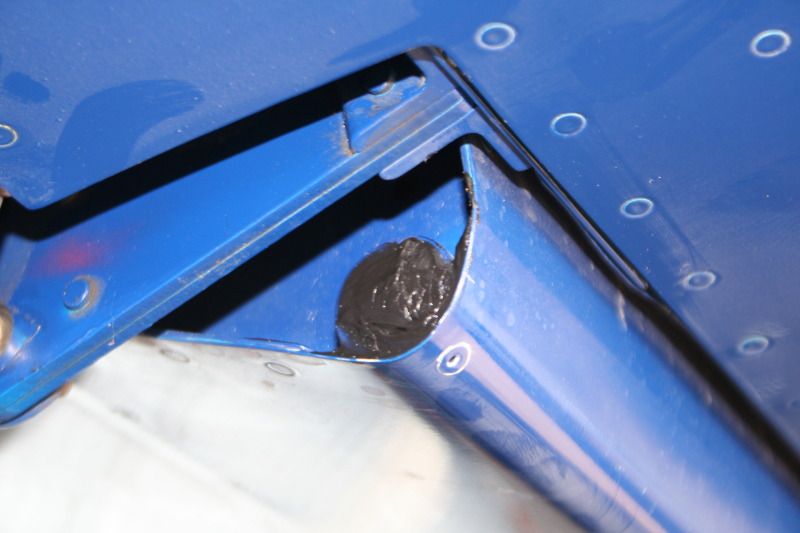

Lately while looking at this area I have started wondering about how much drag I'm getting from the counterbalance pipe at the front of the ailerons. I'm thinking I'll fly a two lap three leg speed test at 6000 dalt then plug the ends of the pipes with RTV and repeat. Another interesting test that I probably will not do is plug both ends of only one pipe.

I've plugged a similar hole on my Cessna 180 (the hole for the tailspring support tube) by just covering it with a piece of tape. It's stayed on for more than 15 years now. Simple, light and adequate.
Of course my IAS has generally been under 175 mph and the boundary layer there is probably thicker on my plane. Still worth trying.
For the flat parts of the gaps - one piece of .016 attached to the skin for the flap half of the gap, and maybe another to extend the bottom skin of the aileron leading edge inboard to the fitting. Your aileron deflections in a race are probably low.
Thanks for the photos, these really help understanding what you're doing here.

What a fiasco - I hate when this happens. It was very hot here today - 102F and it was not a real fun day to be out at the airport (BIG SWEAT!). However, my plan was to test plugging the hole in the end of the aileron counterweight pipe today. I didn't want to remove Nav antenna elements, remove the tiedown rings, and install the fresh air vent covers and tape the various landing gear joints so I said to myself (I talk to myself a lot these days) you need to fly two triangular speed tests as is with WOT, max rpm, leaned for best speed (I kind of faking it here The only thing that is sensitive at this point is EGT and I have come to look for 1300 F - MAP is maxed, speed seems to plateau and is very insensitive to small mixture movements - but I try) at 6000 ft. d alt with full fuel tanks; then plug both ends of one pipe, top off the fuel tanks and fly two more; then plug both ends of the other pipe, top off the fuel tanks and fly two more speed test triangles. Well I got the first two sets of test flights in but not the third.

Ignorant of the precise results of the first flight, I landed, plugged both ends of the right aileron counterweight pipe, topped the tanks and took off for the first comparative test - flight number two. I climbed to 6000 ft p. alt as before and found the temperature was 26C so I descended to 3700 ft and flew the one pipe plugged test.

I plugged the ends of the left aileron counterweight pipe today and re-flew the two triangle speed test under very similar hot (102 F again) windless conditions as yesterday. Temperature at 6,000 p. alt 28 C so the flight was at 3,500 ft with altimeter set at 29.92. The ball was more centered (almost perfect) than during the flight with only the right pipe ends plugged.
The third flight (both aileron counterbalance pipes plugged):
