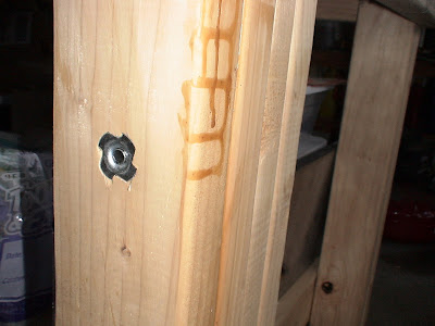

I have 2 EAA tables on wheels and absolutely wouldn't change a thing. I used woodworking platenuts and long bolts and can quickly (less than 5 minutes) change from a long table to a rectangle.
