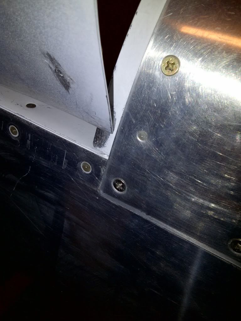

What are builders doing at this interference point? fwd top skin is binding against backing flange.

I cut a slice out of the frame where the contact occurs. You can put MWH tape there but the slice worked fine on mine. On numerous RV4 pre-buys I have seen both approaches, more cuts than anything else.

I just let it rub.

That is exactly the way mine looks, good question.

we can call that a normal problem on the -4. mine does it too.
antichaffing tape slow the deterioration

Trim off the bulkhead and forget about it. Unless you like screeching noises when you close the canopy.
Trim it carefully along the pre-scratched guidelines and you won't even have a noticeable gap or air leak.
