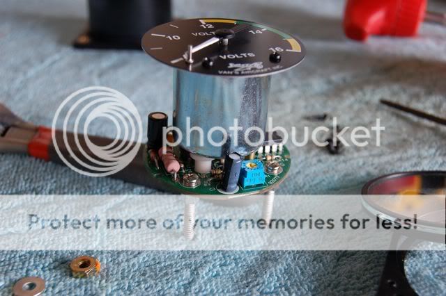

...We had as it turned out, a small problem while returning from a $100 hamburger trip today. I decided to post it here to see if I were the only one or if others have seen this. It was very hot here in southern California today and upon returning to my plane the inside temperature of the cockpit was upwards of 140 degrees. We lifted off for the return trip home and immediately detected a new, unfamiliar smell resembling that of ethylene glycol that proceeded to get worse rapidly. My friend Bill noticed the voltage meter was falling and at that point we equated the smell with an electrical short and begun to fear fire and shut down all electrical via the master. The smell quickly dissipated. After landing I started searching for the problem and isolated it to the volt meter itself. When you show it 12 volts, it reads only ten and after 20 seconds it falls off to read zero. At that point it becomes so hot on the back of the gauge that you can't touch it and it begins to smoke and stink. I am relatively sure, if left with power applied it would soon burst into flames, and most certainly ruin my day. This is one of the $36 Vans 2 1/4" steam gauges and the cost isn't a problem but the potential for disaster is. This didn't pop a breaker or set off a warning of any type, and is most likely an isolated incident. At least I hope this is the case! If others have seen this please let me know. Thanks, Allan...

I had similar experience with Lucas voltmeter during Phase One. The same symptoms but without melting the gage. After dissassembling I found a burnt part then ordered new gage. Still working.

What size fuse/breaker did you have installed in the instrument supply line?
This should have blown if the current drawn was large enough to generate that much heat.
Van recommends a fuse/breaker in the supply, but I'm not sure if he gives a value...

...I have one of the ceramic so called smart power panels that should have shut down this circuit at 3.5 amps. I wish it had individual breakers and old school switches instead. Allan...
