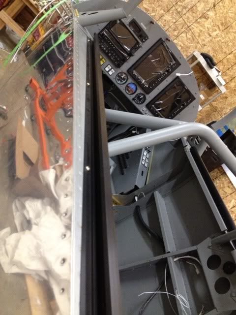

I had mine anodized. They seem pretty tough but we will see how they wear over time

Had mine black anodized at Electro-Chem Metal Finishing, Portland, OR. $30 and 5 day turn time. Look just like pic posted by azonic75

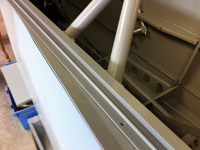

I powdercoated the rails to match the gray interior. There was some minor chipping over time but not too bad.

Decided to get the rails hard anodised.
Came out brilliantly.
Not cheap - over $100, but very, very tough and blended in superbly with our grey interior.
Very pleased.
