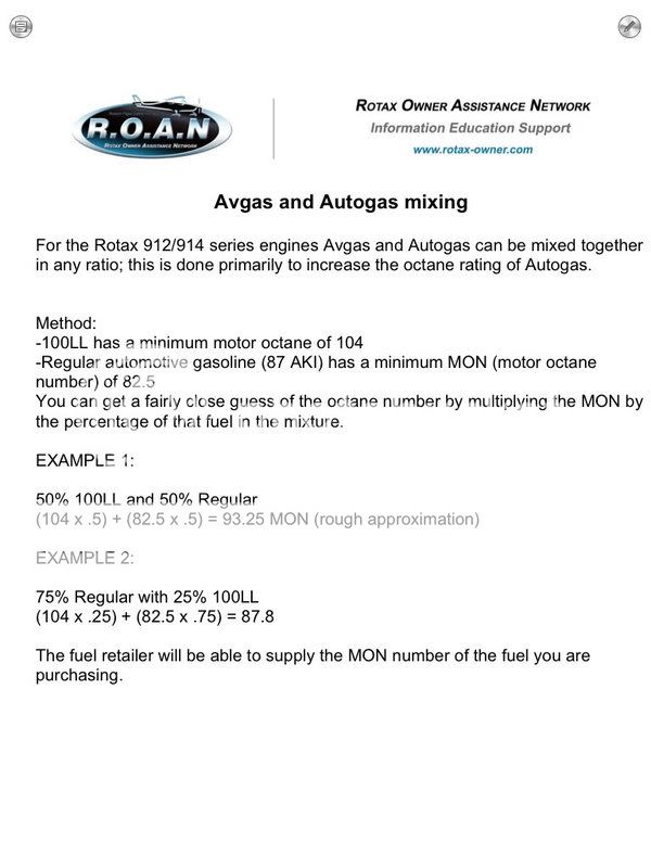

Thank you very much everyone for the useful information. One remaining question for RV-12 pilots: how do you deal with the limited availability of mogas on a cross-country ? Do you fuel your plane with avgas exclusively, do you mix avgas and mogas depending on what's available, or do you limit your fuel stops to airports where mogas is available ?
Thanks again,
Marius

Talking Mix it baby!
Get a fuel set up for your hanger. Mix 50/50 when away from home base.
Flying 800 nm to OSH using no 100ll.
See this web link for a listing of mogas airports.
http://www.flyunleaded.com/mapusairports.html

I use a Flow-Fast 15-gallon tank with a hand-crank pump and have 3 5-rallon cans for refilling the pump. If I'm going to re-fuel off airport (very rare since I just fly for fun) I carry a can of Decalin fuel additive-- safer in the airplane than TCP.
