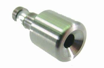

Default Avery 3/8" Diameter Dimple Die
I used a 3/8" diameter female dimple die from Avery Tools in my pneumatic squeezer. It works perfectly for dimpling nutplates:
They're on sale now at Avery Tools:
http://www.averytools.com/prodinfo.asp?number=14870
