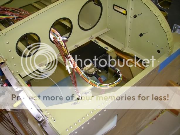

Well gentlemen----------------Ideas afloating! love all your pictures. I see what you mean about laying it all out first. Great idea on the nutplates under the ribs and sub panel. THATS A GO! I like the sounds of locations for the back up battery. I forgot about that one frankly. I now know where to penetrate the firewall. Thats good! Like the switch layouts. OH guys I believe the larger panel is 2" deeper and you cut the the height to fit. On that note of the panel, my buddies have said that getting in and bending the knees to fit under the panel (if you are a tall guy) is a little more difficult.. You all have made this a great discussion and keep it up. Lots of the builders are watching so thats cool. I'll be back on tommorrow night to check. Thanks guys.

Originally Posted by Buggsy2 View Post
how do you do that?
It's pretty simple, really. The F-745 rib, or ribs, are simply cut off flush at the sub-panel. The aft ends are moved left or right and re-mounted on the sub-panel wherever you wish, using some homemade angle brackets. I've already cut my left one off, anticipating a 10" screen right in front of my face.
Ron in Oregon 9A
The nutplates on the ribs can also be used to attach cross angles for mounting "stuff" on. Screws inserted from below, of course...

Chip and Richard, Where did you get your switches from? Nice panels. Gil nice wiring job. Neat. Someday I'll learn to tie!. Hey got a answer to the stainless screws in the wing tips. You heard it first here. I took a AN507-6R6 screw to the Buffing wheel a WA-LA a polished bright head looking like chrome. The answer to the corrosion gossip with stainless steal screws. Cheaper too!

Gil Im liking that you put a couple of angle brackets underneath with nutplates. Im thinking of feeding on the idea by putting a hinge and a plate and have it drop down with one of those modules on the plate. I going to make my wiring neat like yours. It just doesn't get prettier then that, Great job Gil. Thanks for the inspiration my friend.
Thanks guys for the websites on the switches. I like them. I wondering if the the LEDs are dimable?
Stainless screws. Got a NEW IDEA here. AN507 6R6 screw I put to my buffing wheel (just the face) and WA LA. Chrome looking face but still the coated screw into Aluminum and nutplate for the threads. I have to put some out in the rain for a while to see how they do.
