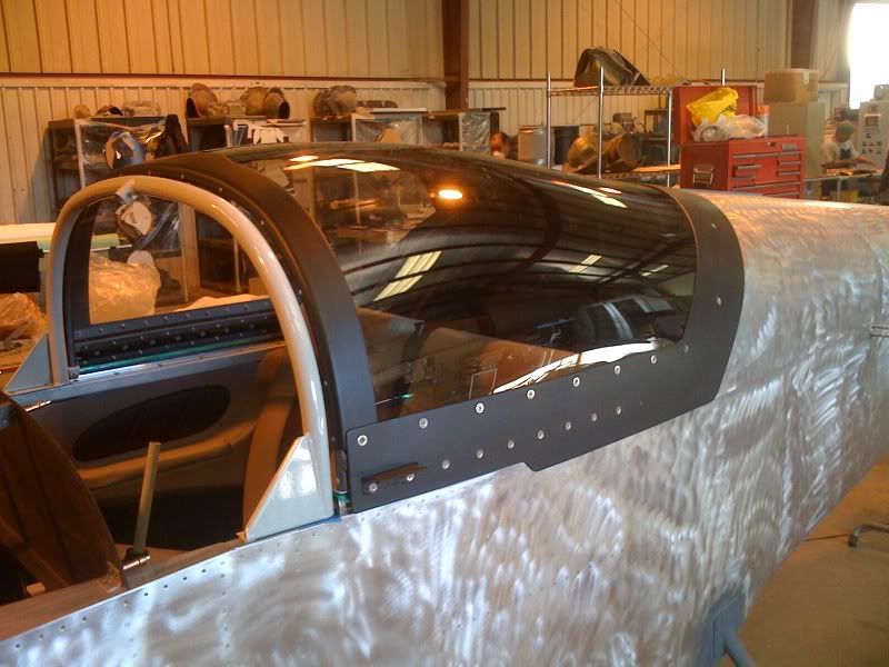

Hey Willam,
This is what I did. My skirts are thicker then most I think. I "think" I use 3 7oz. and 3 carbon. The last layer of carbon I put on after the first layers were sanded down, filled, and super smooth. Everything is screwed down. The reinforcements were made in carbon right off the aluminum ones.

wow - that looks great. Nice job!

I made a fiberglass rear skirt but kept the aluminum side skirts. I attached the rear skirt with counter sunk screws along the rear roll bar and riveted/epoxied the rear skirt to the aluminum side skirts.
For the main attachment at the rear, I took the following approach:
1. Drilled the rear roll bar and plexi for screws focusing mainly on how best to attach the plexi to the frame. I drilled through the frame and used nuts on the interior
2. When I was ready to attach the fiberglass skirt, I removed every other screw from the canopy and put the rear skirt in place.
3. Back drilled the fiberglass where I had removed the screws.
4. Counter sunk the fiberglass so the heads sat below the surface.
5. Attached the skirt to the frame.
6. Worked on the side skirt
7. Did the final filling and shaping when I was sure that rear skirt was on to stay

One more note. My plexiglas is only mounted with screws on the sides and down the center. The front and rear are just siliconed.

I laid up a one piece skirt from 3 layers of glass & 2 layers of carbon. I used Sika to bond the canopy to the frame, no holes through the plexi other than for the latch on top. I attached the skirt to the frame & canopy with Sika 295, but also ran blind rivets into the outside surface of the side bows per plans. C791 reinforcements are blind-riveted to the inside of the side bow, again per plans, likewise riveted to the skirts with solid rivets.
Chris Frisella is an artist with carbon, mine is workable, but his looks so much better than mine that I'm going to decline posting photos
Like Chris's, mine is also a fair bit thicker (like maybe 3x) than the stock skirt material, but it's rock-solid, and you can't slide a business card between the skirt and the fuselage skin, anywhere.

Thanks everyone for the information, sounds like I'm on the right track. The main concern is how to secure the skirts to the frame and it appears I have 2 options. Either secure with screws/rivets, or glue on. I originally was going to go per the plans with rivets to attach the skirts and the c-791, but I'm very concerned with the possibility of the rivets pulling through the fiberglass/carbonfiber over time especially since these rivets will be countersunk into the skirt. Any thoughts on this?

Yes... the aluminum skirts work the best and are really easy to install.
