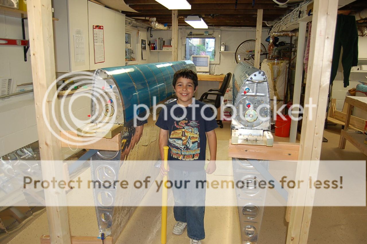

Old 04-22-2012, 12:44 PM
Posts: 8,151
I didn't sweat it. Sturdy 2by4s anchored to the concrete floor and screwed to the beams on top.
Old 04-22-2012, 01:05 PM
Join Date: Feb 2011
Location: USA
Posts: 3,179
Vlad, that self portrate suggests you aged a lot over the course of your built!
