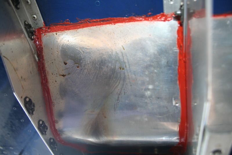

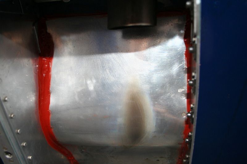

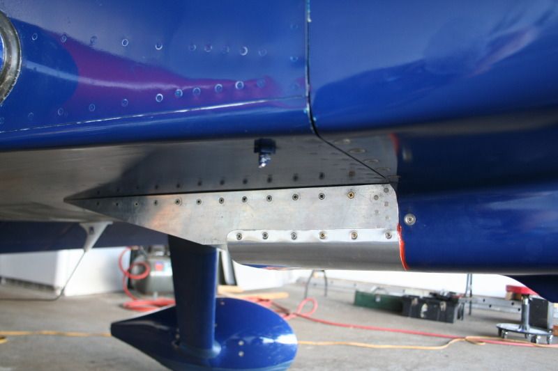

I went back to the airport today with the intention of patching the cutouts on the development cover but it looked liks a very messy job with the location of the mounting interface and a previous patch so I spent 6 hours making a new cover.
When I pulled the development cover off, the right Channel was free of any mark but the left channel had a elongated brown smudge on the high part of the bump.
This is from the breather which is directed onto the left exhaust pipe. On the back side of the bump following the line of the streak there is a swirl to the left (counter clockwise) from near the center to the inside of the left flow fence (sorry I had to reverse the photo direction to get the picture):
This indicates to me that the flow is not linear and may be influenced by the exhaust cutouts. I have no reason to believe the the flow in the right channel was not similar.
When I finally got the new cover fabricated it was near dark so I could not do a proper speed test.
It sounded loud as you would think an exhaust pipe stuck in an enclosed chamber would sound. I only got up to 4,500 ft MSL but it would not surprise me to find that it was near 6,000 ft D alt. The highest ground speed I saw was in the 180s and the TAS on the AI was around 170. I was not impressed.
Tomorrow I have to fly to Llano, TX for a race on Saturday. I cannot do a formal speed test enroute because I do not have enough fuel. Maybe I can do one down there. I don't want to run the race with a suspect configuration. I have to try to remember to take the thin triangular flow fences that I can swap in tomorrow at Llano it the speed test is bad.
I am interested in the results of the covered test (gut feel - it's gonna be bad) and the open channels with the bumps (hopefully better). I have my thoughts on why but I'll let the results speak for themselves.

Looks to me like the bumps are working. The exhaust and airflow are staying attached to the bumps. If they were not staying attached, I think the swirl would not be there and you may see some reverse flow; I do not see this in the picture. I am curious to see the speed results, but I bet you are right. Maybe all it needs are some generous fillets on the inside?? Just guessing.
Thanks for all these experiments. I suspect there will be a new "stock" exit coming from all of this. I cannot question the speed increase, it seems very real.

I will continue working on this because I think there is something to be gained but I don't claim one microknot yet. My best speed to date is 184.4 KTAS. Until I pass that number I'm just thrashing around looking for speed.

Listen to Mr. Axsom, who is being realistic....he is getting speed changes, but so far none of it is actually making it go faster.
The latest photos pretty much confirm a lack of any actual Coanda Effect; little or no exhaust staining (exhaust jet not attached), and the oil swirl on the backside (separation).
Consider these sketches.
This is more or less what Bob has now. Red is the exhaust jet and pink is cooling exit flow.
Realign the exhaust jet so it impinges on the curved surface and you see the Coanda effect....the attached flow turns the corner. Close the exit area by moving the hump forward and adding a bit to the lower cowl (cyan). The result is an entrained, exhaust-augmented cooling flow. Yes, you might lose a little power, as Bob noted earlier, because local pressure at the pipe mouth is higher than external static. After all, the engine is an air pump.
