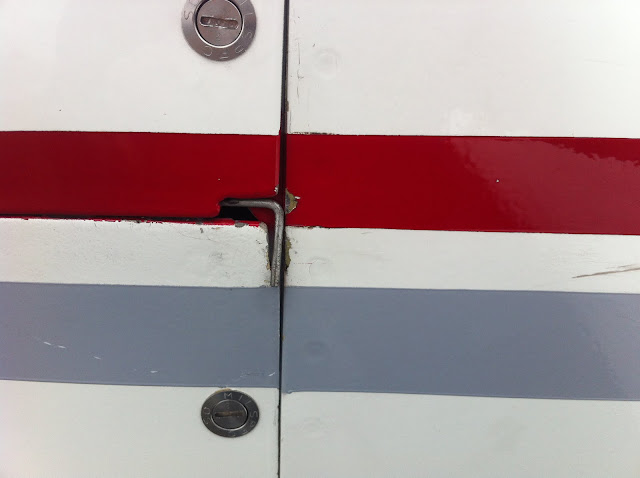

This is how I did mine - works fine.
Normally, it is hooked under the cowl a little - needs the occasional tweek !!
