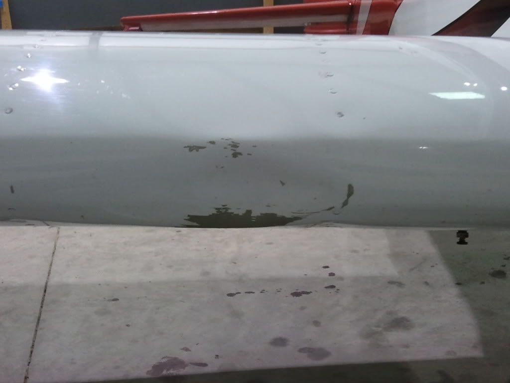

Two guys I hanger with had bird strikes on Tueday evening. Flight of 2 RV8's have bird strikes at 180 kts. Not sure who ran into who.....Damage to 1st RV8 consists of a nerf football size dent in the leading edge of the tank. Second RV8 took it right through the front windshield.
Both landed without incedent other than a few stitches and brown shorts for the second RV8 aviator. No idea what kind of bird or how big. All I can say is WOW!!!

Looking at the pictures and I am hoping all that blood and guts are from the bird.

To repair the dent you might consider your local "paintless dent repair" guy. I had a similar encounter which was repaired in my hangar (his tools were in his truck). I did remove the tank and cut 5" access holes in the baffle for him to reach in from behind. Dent is gone. Paint is intact, and you have to look very close to see any evidence of the fix. Two hours and $250. Because of the sloshing issue, Vans sells a special baffle repair kit.
