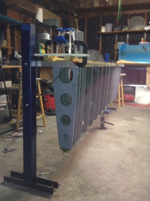

It's been a long time coming! Feeling like I've made a big step forward after stepping away from the build for almost two years.
Big thanks to Rudi for having his jig plans online. A few changes made to fit my situation, but over all a great design. Still want to build some supports for each ends of the rear spar.
FYI, the photo doesn't do it justice, but the blue I painted the posts are going to be the main color of the plane.

I too am planning to use Rudi's design, but I am torn with the prospect of drilling my brand new shop floor for the feet. Having straight Wings sure outweighs a few holes in the floor though.
Since I have yet to do the epoxy floor coating, I figure I can get the Wings done, remove the stands, fill the holes and expansion joints and paint away and the next owner will never know.
I like the blue!

Im with you. Once you cut off the anchors and patch them, no one will know. Small price to pay in order to have a solid foundation for our expensive wings. I only had to drill two holes per post and they are solid as a rock
Rudi's plans call for 2x4 metal posts. I found some 3x3 at a local metal supplier for half the price. They even cut the posts to size for me.

Where can I find a link to the Jig Plans Online?

recommend some sort of padding on the right angles on the floor pieces

Are you referring to the Vans plans or Rudi's plans? Vans are not online but are in the Preview plans for each M&M of aircraft kit that Vans Sells. if you are looking for Rudi's plans for the metal stands, here is the link to his website:
http://www.rudigreyling.com/rv_tip_stands.html
For some details about the hardware that I used, you can refer to my blog entries by clicking on the Wing stand label.

I beveled the upper ends of my angles at the advice of other builders, and that helps a little. But as you point out, maneuvering around the stands while bulding the wings may very well result in catching a toe or two before the wings are off the stands and ready for the cradle. Steel is very hard and unforgiving to the human body!

I avoided the toe-stubbing issue and the holes in the concrete with this RV-3B wing jig. It also lets me build both wings together.
The adjustment bolts on the bottom of each leg are Bondoed to the garage floor. When done, that chips off.
Note the cross-wires in the top. They add rigidity.
Toe stubbing wasn't so much what I was concerned about as tripping and bashing my partly-built wings.

Awesome idea Dave. I'm going that route. I may call when the time comes. Looks like it could be used as a paint booth if no wing were in it. I just took both HS apart for rebutting, dumpling, sanding and priming. Wings are a month or two away.

I used Rudi's plans and they worked great. Painted the left wing stand red and right green to help prevent stupid mistakes while building both at the same time.
Got a little help with the left ones.
