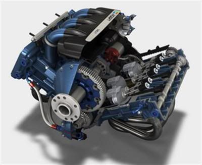

Has anyone read up on Mikes post #36 a V6 smaller than an IO 360 and lighter, up to 320 HP.
