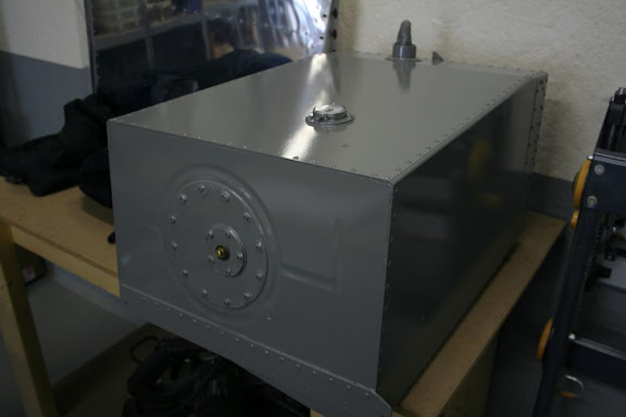

I'm down to the final home stretch now on Kit #120221 and hope to fly by Memorial Day. The engine is mounted and practically ready for first start. Skyview is in-hand and the wiring modifications are going as well as can be expected. Which brings me to the fuel tank.
This past weekend I was showing my completed and leak tested fuel tank to a friend who has built an RV-9. We discussed the sight glass and the problems many RV-12 builders are having with leakage in this area. I described to him how the Moeller fuel gauge is being used as a retrofit with the sight glass area blanked off after E-LSA certification has been received. We then discussed Service Bulletin 11-12-14 (Frangible Bolts), which requires removing the access opening from the front of the tank and subsequent resealing. His suggestion was so simple, that I was kicking myself mentally for not thinking of it first.
Install the fuel tank as-is, optain E-LSA certification, and fly the plane. Order all parts for a replacement fuel tank from Van's, including the Moeller fuel gauge from another source. Build the replacement tank with all the desired/recommended modifications and then install it during the first annual inspection or when the first leak appears in the in-service tank, whichever comes first. Why go to the trouble of tearing into a perfectly good fuel tank, which will delay project completion? Brilliant!!!

My DAR required a list of all service bulletins and had me sign a paper stating that they were complied with. It might be considered perjury or fraud if a false statement is made. Your DAR or FAA inspector might be knowledgeable about the fuel tank service bulletin because it is one of the most important ADs.
If the RV-12 is flown without the fuel tank upgrade, the tank could rupture during a forced landing on rough terrain. And forced landings are more likely during the testing phase. The fuel tank did rupture in one RV-12 that made a very hard landing. The pilot was sprayed with fuel and was lucky that there was no fire. That incident was the reason for the service bulletin, to prevent similar incidents.
Although there was a problem with the original sight glass, the revised one has not been a major problem. Fuel leaks are unlikely in a properly constructed tank. While the fuel tank access port is open for the service bulletin upgrade, a hole can be cut and a reinforcing ring can be installed in preparation for the future installation of the Moeller fuel gauge after certification. See Don's post on the subject:
